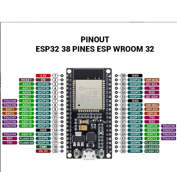

Hi, I just wanted to ask a help regarding my project. I need to send data using my ESP32 38 Pins and SIMA7670E GSM Module. I tried AT command testing via PC, and it went well. However, whenever I've tried to test the AT Commands with ESP32, it shows unreadable text.
My A7670E pins are: VCC, GND, RXD, TXD, VDD, PWR\_EN, GND
Here's how I connected their wires:
A7670E VCC TO EXTERNAL 5V 2.4A
A7670E GND TO EXTERNAL GND
ESP32 GND TO COMMON GND (WHERE EXTERNAL GND IS CONNECTED)
A7670E RXD TO GPIO19 TX
A7670E TXD TO GPIO 18 RX
A7670E PWR\_EN TO GPIO4
I TRIED USING A DIFFERENT BAUD RATE, BUT IT WAS STILL UNREADABLE

THIS IS THE ESP32 I HAVE:
 ![image](https://europe1.discourse-cdn.com/arduino/original/4X/1/9/d/19da0d54113105a8d9e2e4efc676a48567a81775.jpeg)

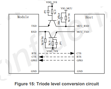

> [@danuzu](#):
> `A7670E`
Did you connect the module via a converter?

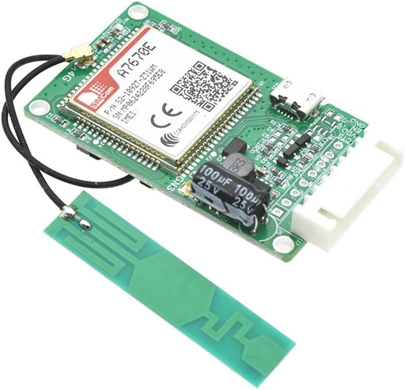

> **[SIMCOM A7670E 4G LTE Cat1 Module 4G LTE Cat1 Module with SIM Card Slot TTL...](https://www.lazada.com.ph/products/simcom-a7670e-4g-lte-cat1-module-4g-lte-cat1-module-with-sim-card-slot-ttl-uart-2g-lte-fdd-b1b3b5b7b8b20-gsm-9001800mhz-i5187709308.html)**
> Acmdehk. SIMCOM A7670E4G LTE Cat1 Module 4G LTE Cat1 Module with SIM Card Slot TTL UART 2G LTE-FDD B1/B3/B5/B7/B8/B20 GSM 900/1800MHz. A7670E. The A7670 series is the LTE Cat 1 module which supportswireless communication modes of...
I used this kind of A7670E GSM Module
I do it this way:
TX ----\> RXD
RX ----\> TXD

Simcom A7670E 4G LTE Cat1 Module
> **[Cenei SIMCOM A7670E 4G LTE Cat1 Module A7670E 4G LTE Cat1 Module with SIM Card...](https://www.amazon.co.uk/Cenei-SIMCOM-A7670E-LTE-FDD-1800MHz-Green/dp/B0F7LVJT2P)**
> (Different batches may have slight differences in appearance, which not affect the use)Small size LTE Cat 1 moduleLGA form factor with abundant interfacesSuitable for LTE and GSM networksAbundant software functions: FOTA, LBS, The form factor of...

the website presents a lot of nice pictures but no information on connections and how to use the device, e.g. are the Tx and Rx 3.3V logic or 5V logic?
ask the vendor where you purchased the specific SIMA7670 module for a datasheet?
