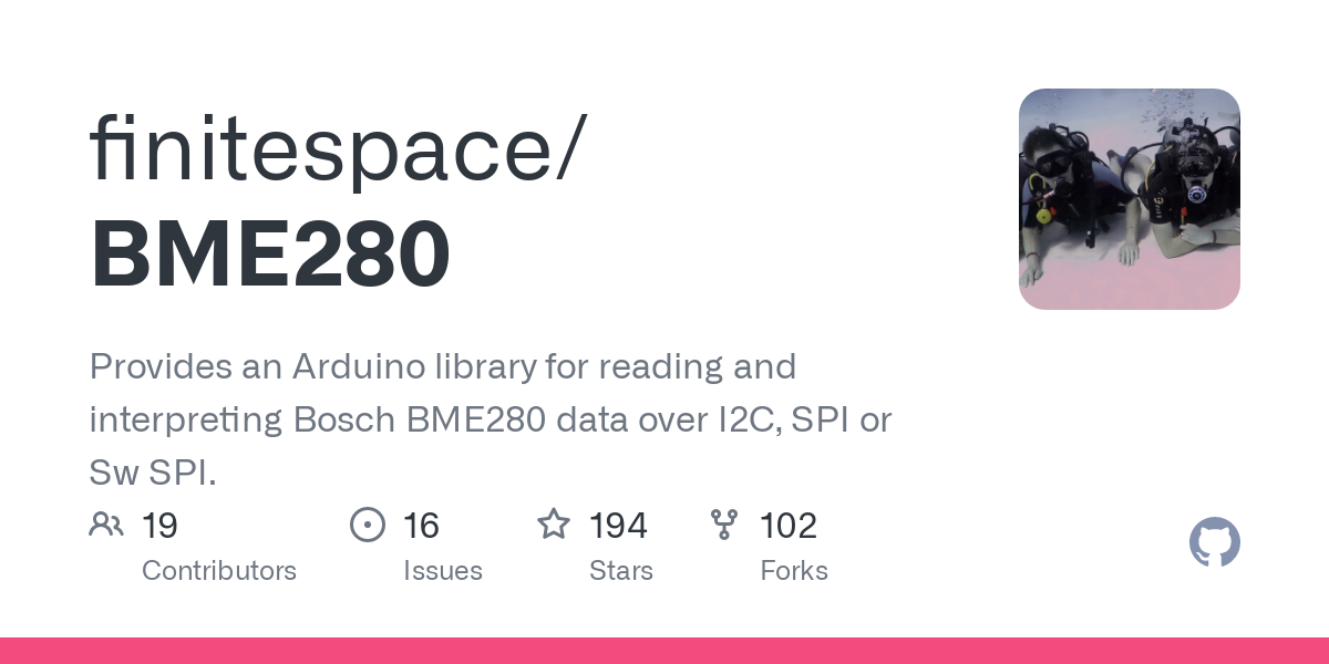

Post a link to where you got the library EnvironmentCalculations from. Please use the chain links icon on the toolbar to make it clickable. Or if you installed it using Library Manger (Sketch > Include Library > Manage Libraries) then say so and state the full name of the library.
Thank you for your answer.
I used the Library from GitHub - finitespace/BME280: Provides an Arduino library for reading and interpreting Bosch BME280 data over I2C, SPI or Sw SPI.
The Library EnvironmentCalculation is also in this Library included.
The error message is saying that you are passing more than three arguments to a function that takes three arguments in this line:
  float seaLevel = EnvironmentCalculations::EquivalentSeaLevelPressure(barometerAltitude, temp, pres, envAltUnit, envTempUnit);
I count five arguments. Check the examples or documentation that came with the library to see what three values it needs.

Oops, that should have been obvious to me.
It looks like you're using the 2.3.0 release version of the library. That version's source code for EquivalentSeaLevelPressure only takes 3 parameters but the Environment_Calculations example passes 5 arguments to it. In the most current non-release version of the library it does take 5 parameters. So, although generally I would recommend using release versions of libraries unless you're doing beta testing, in this case it would make sense to update to the latest version of the library:
