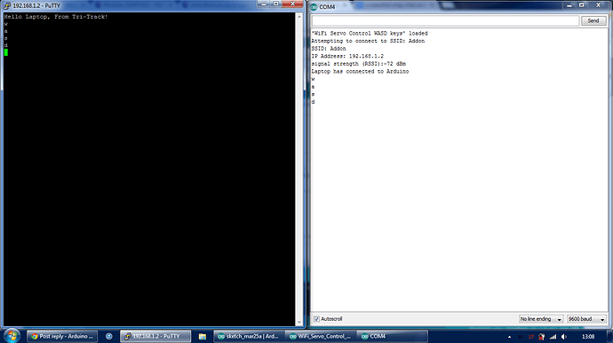

Hi guys,
I’m working on a very similar project as to that outlined here. New to the Arduino world and enjoying it so far! :slight_smile:
I want to be able to control a number of servo’s by sending keyboard keystrokes i.e. not having to press the enter key each time I want to increment servo position. Currently in the early stages of development; I’ve used the code supplied by MF4040 and adjusted it to my own needs. I’ve started with 2 servos, which increment/decrement their position on pressing the WASD keys (as shown in code below).
I’m connecting to the arduino via a telnet connection using PuTTY…

I know my code is less than robust! Still learning! :slight_smile:
I want to be able to change servo position on a single keystroke and not need to hit the Enter key each time
If anyone on this thread could give me a helping hand it would be much appreciated!
What do you need help with?
At the moment I can adjust servo position on entering W,A,S,D followed by a carriage return into the Telnet client. I want to be able to read if the keys are being pressed in real time and adjust servo position accordingly i.e. not have to hit 'Enter' after each keystroke.
I hope that clarifies?
edit: formatting
"the Telnet client" doesn't tell us anything. You need to be more specific.
I'll try my best...
Once the serial connection to my uno/wifi shield is up and I can see that the shield has connected to my network, I'm using PuTTY to set up a Telnet client to connect to my arduino's IP address on Port 23:
As you can see from the image, I open the client and can adjust the servos by entering either W,A,S or D.

It would probably be a good idea to constrain the values BEFORE writing them to the servos.
It would definitely be a good idea to use Tools + Auto Format to fix the indenting in your code.
It would definitely be a good idea to explain what the problem is. If the issue is that you need to hit the enter key after each letter, you need a different telnet client - one that automatically sends each letter as a packet, which might be hard to find, as most of the time, you do NOT want to send one letter per packet.
Ahh yes, that is a good idea. Thank you!
This is the issue. I'll see what I can find :/
Thanks for your help.
Edit: Done it!! For anyone browsing this thread in the future. PuTTY has a 'Local Line Editing' option under the 'Terminal' tab, select 'Force Off' :)
