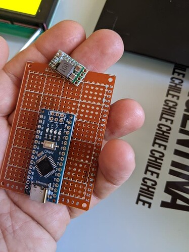

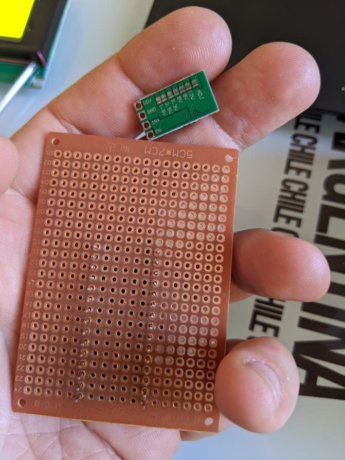

How do I place this buck converter onto this perf board?
I have a small perf board and I need to fit this buck converter on it:
This is the back:
How do I place it nicely onto the perf board? What's the best practices to make contact with the board's traces?

PCB header pins, just like the Nano.
I am asking how to solder things to the board. I fail to think how the schematics would even remotely be in this picture. Seriously. Nor wiring.
Thanks for your help.
Ah I see. So I want a single row of 4 header pins, yes?
I thought you were asking about placement/fit and that it might depend on where the power is coming in from and where the power is going out to.
No, not placement -- I am trying to figure out how to even stick it to the board, anywhere.
Yes, I am that clueless...
(I am learning slowly)

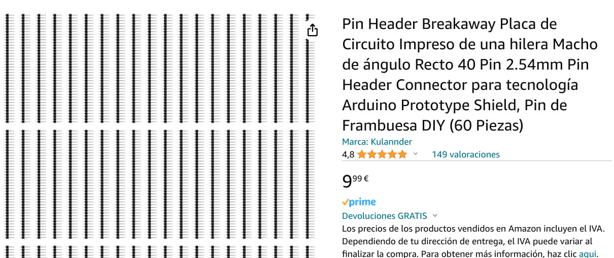

Should I get something like this:
Will I need to place something between the board and the circuit to prevent contact? Or shall I attach the buck converter in the other non-contacts side of the perf board?
I am clueless, sorry.

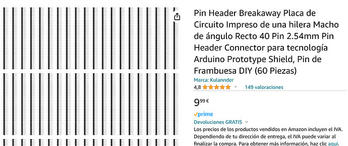

They are right angle. You need 4 straight pins:
What is right angle?

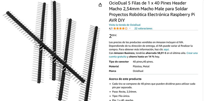

Ah I see. Sorry I actually got these:

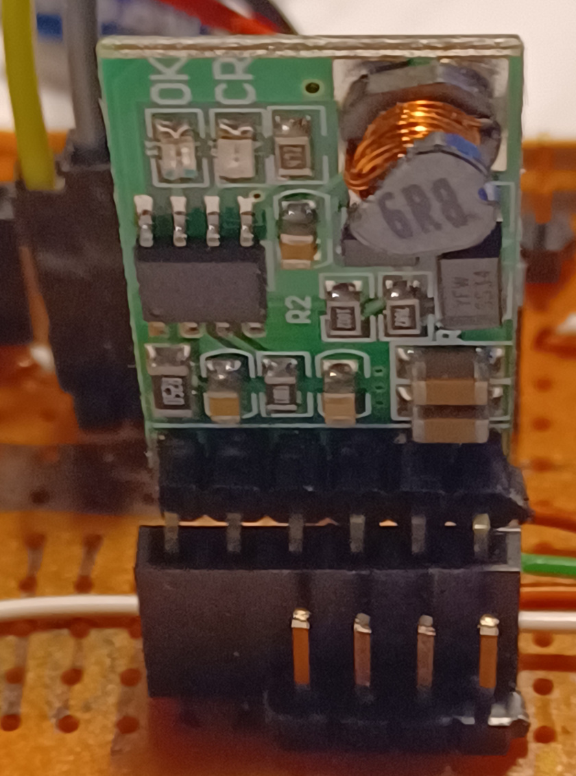

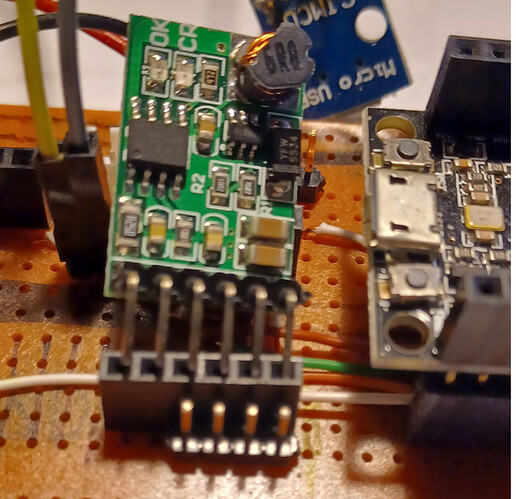

Use right angle pins on the converter and a socket on the perf board.
