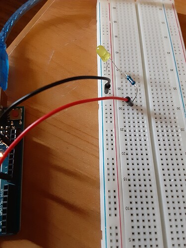

this is my question though, just got the ultronics kit as a newby. Now Ive written about 3 programs from a turorial on you tube, lighting up the led light on the breadboard. Made in to the analogwrite chapter and nothing works anymore. this is my error code. And also none of the lessons in the ultronics book offer no codes for there projects. so i downloadedd them, but they dont work. HERE IS MY CODE
void setup(){
  pinMode(8,OUTPUT);
  void loop(){
      digitalWrite(8,HIGH);
There is no error code just nothing happens

What do you have connected to the wires?
Pin 8 to LED anode, LED cathode to a resistor, then resistor to Gnd?

Show us a good schematic of your circuit.
Show us a good image of your ‘actual’ wiring.

hERe is a pic of the breadboard. but i think it has something to do with my app?

If you connect the red wire to the 5V pin, does the led light up?
Your LED is in backwards.
