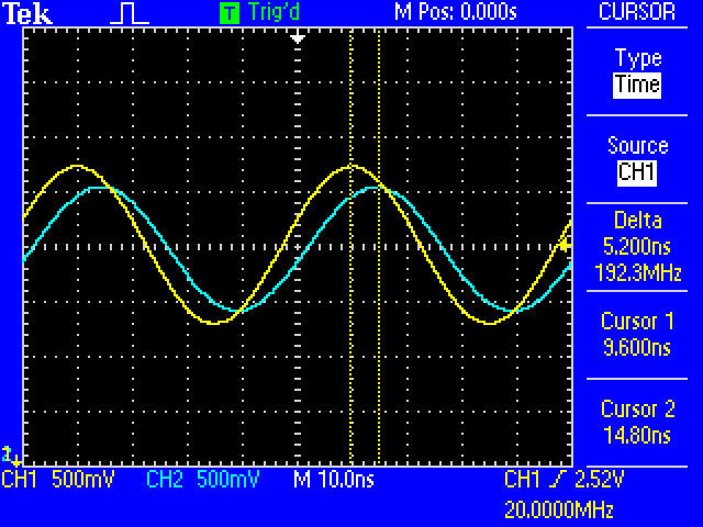

I happened to have one lying around, so I hooked it up to test. It does indeed do what you said. If I supply an analog signal (eg. a sine wave) on either the input or the output, it is replicated at the other side, pretty-much exactly. Careful measuring seems to suggest around a 5 nS lag from input to output, which is consistent with the datasheet.

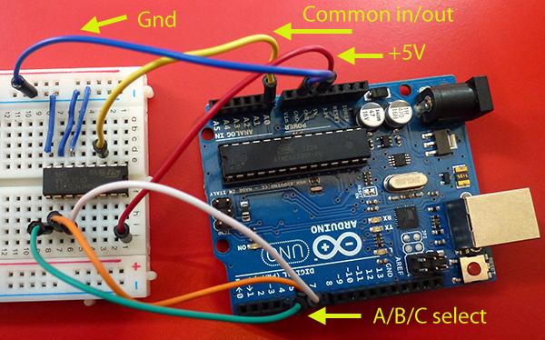

I've done a tutorial on using them, as I couldn't find many hits when I tried to search for them before.

Ach, now I'm going to have to set up my test again. I was getting reasonable results at 10 MHz, that is, I was starting to doubt my measuring equipment more than the chip.

This is what I am getting at 10 MHz. Ch1 (yellow) is the input and Ch2 (blue) is the output.
The part number is M74HC4051B1R.

The picture below is running at 20 MHz. The lag of around 5 nS is pretty clearly visible.
