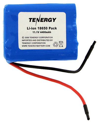

Hello :
i recently received this battery in the mail ;
it's a three cell lithium ion battery ; i built one like it before .
this one though has 2 pins only ; supposedly + and - . not fit to be connected to the balance charger
i usually use for these batteries ; the apparent solution seems to just connect it to a 3amp 12V DC line .
however i wanted to ask here just to make sure that's safe .

It's not even close to being safe trying to charge a Li-ion battery from a DC source unless it has current and voltage limiting and you really know what you're doing. If you're good with a soldering iron perhaps you can fit a balance connector to it. JST- XH connectors are easy enough to find.
Steve
amine2:
I too would be surprised if that is safe.
When charging Lithium batteries you really do need to do it right and the datasheet for the battery ought to give you some idea as to the charging possibilities of the battery.
Did you check the datasheet ?
Some packs have a built-in charge management and balancing controller. If there's a datasheet for it, check it out. If its just 3 cells in series without any protection you are taking a risk.

Hello : thank you very much guys for your attention and i am very sorry for responding late it's because of my work schedule .
the datasheet (as brief as it is) does indicate that there is a "safety board" on ; which probably is just a
BMS (battery management system) ; limits charge and discharge currents and protects against over-voltage .
here is the datasheet : https://docs.rs-online.com/72de/0900766b815d44d6.pdf
i refrained from that solution since you guys said so ; again all this battery has is two pins .

You should be aware that it is safer to use 18650 individual batteries with a BMS because it allows monitoring
of individual battery levels and current and prevents overcharging of individual batteries. The pack you purchased may only have two wires but in this case less is less and more is more, meaning you would be
better off having access to each battery in the pack and a BMS that can control the charging .
