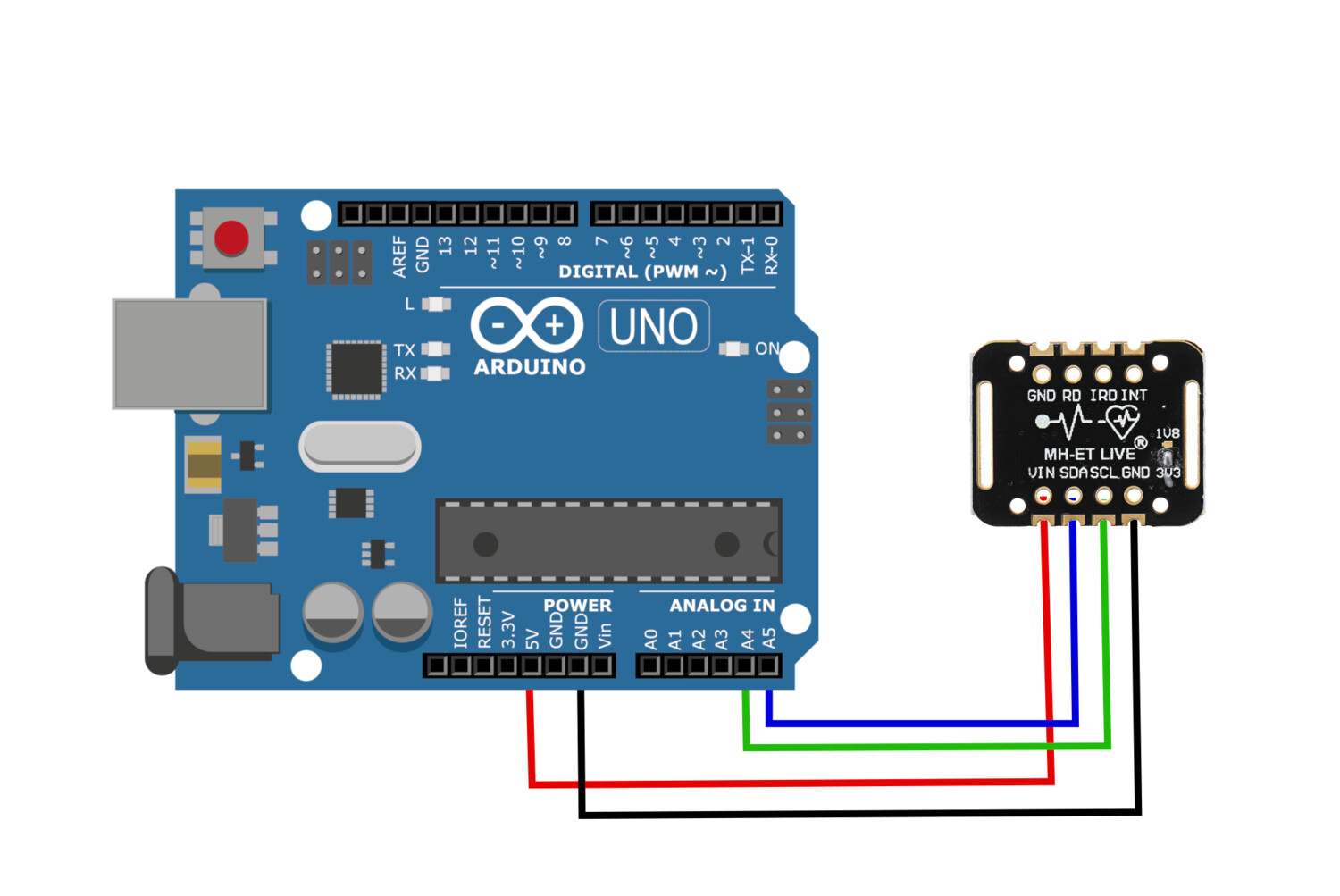

I am using 2 devices.
1. MAX30102 for Heartbeat
2. DS18B20 for Temperature
I tried the example given by SparkFun Library (example 5) and DS18B20 library [GitHub - matmunk/DS18B20: Arduino library for the Maxim Integrated DS18B20 1-Wire temperature sensor.](https://github.com/matmunk/DS18B20).
When i try to use the code for temperature, that is DS18B20, the heartbeat values are not displayed. Can someone help me in displaying both heartbeat and also temperature values?

**1.** Post the sketch that works only for Hearbeat Sensor -- do not include codes of DS18B20 Sensor.
**2.** Post the sketch that works only for DS18B20 Sensor -- do not include codes of Hearbeat Sensor.
**3.** Now, carefully merge the above two sketches so that both work.
**4.** If possible, please acquire the address of the Heartbeat Sensor and post the value.

Temperature,
 ![image](https://europe1.discourse-cdn.com/arduino/original/4X/9/1/c/91cf1853c6cd1cdc319192d611d655daeb0ca81c.png)
For heartbeat,
 ![image](https://europe1.discourse-cdn.com/arduino/original/4X/1/8/0/1808361ed1d97df2b92c635a3748f35ea66e3cd5.jpeg)
When i comment out the temperature code heartbeat code works correctly.
When i comment out the heartbeatcode, the temperature code works perfectly.
If i keep both. Only temperature code works.

You only have one device, the DS18B20 that is connected by 1-Wire.
The MAX30102 is communicating by I2C.
I'm not sure whether this is the cause of your problem, but the DS18B20 takes more than 600ms to do its temperature conversion. It is likely that during this time the MAX30102 misses heartbeats.
