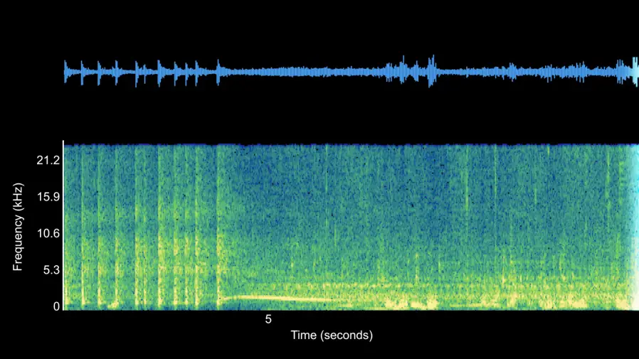

I want so much precision that I can generate a traditional 2D Sonar like graphic. Also I want to see the frequencies I am emmiting and all the others, on a Spectrogram (Passive Sonar). Because there is much to learn about sounds under Water.
So if you want to see the shape of the returned wave then you have to allow for al the harmonics as well. This only leaves a "flash converter" for your A/D and these are very expensive the last time I looked. They are used in high definition TV digitization. I also tend to think that this puts it outside of the sort of speed you can get from a processor and you are into the realm of using FPGAs, which are another step in complexity and several times more expensive, especially for the lone amateur.

The 2d graphic will be around 240p
I don´t want to see the shapes of the waves. I only want to see a line, like in the Picture below.
