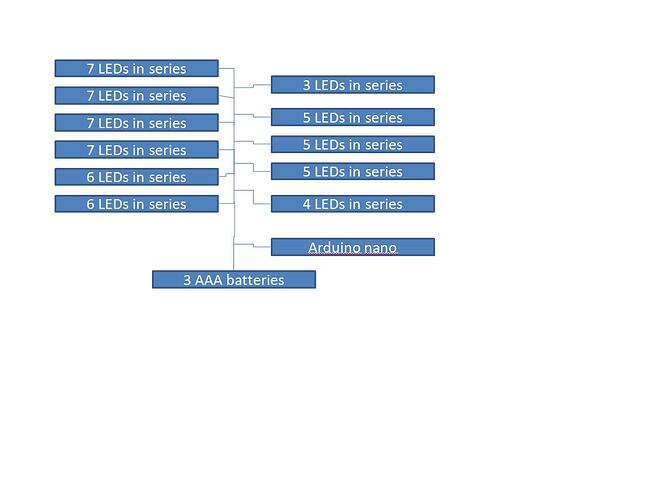

How do I calculate this? I'm pretty sure I don't have enough voltage to power this up but how much do I need? I have 3 AAA batteries equating to 4.5 V. I have the attached wiring setup. I measure the voltage of the bus to be about 1V. Not enough to power anything.

The Op's "diagram"
Almost all aspects of which are wrong. These LEDs are not in series but as far as the power supply is concerned they are in parallel.
Each LED will take at maximum white brightness about 60mA, so for 60 LEDs you require a current of 55 * 0.06 = 3.3 Amps.
You can not get this much current out of an AAA battery by several orders of magnitude. You need a mains power supply or quite a substantial battery power pack.
That sounds bad. What do you mean by "bus"? Where did you measure 1V and how? What else was connected?

So in my picture there's an arduino nano. I removed the nano and placed my meter there. That main trunk of 24VDC and 0VDC...isn't that called a bus? Nothing else was connected. What do you mean "sounds bad"? Should I have planned/wired it differently?

Looking at the 18650s they output as much as 30A per cell? and I need only 3.3A. Why is it a "maybe it will work"? How many over these 18650s should I get to make this config work?
No it is not.

I removed the nano because I was afraid of damaging it (Yes, I'm a noob). Yes I should've measured with the nano. But when I was testing it I was testing to make sure all my connections were made properly. I'm certain the nano will turn on.
yes I was measuring voltage. I only measured 1V with 3x AAAs.

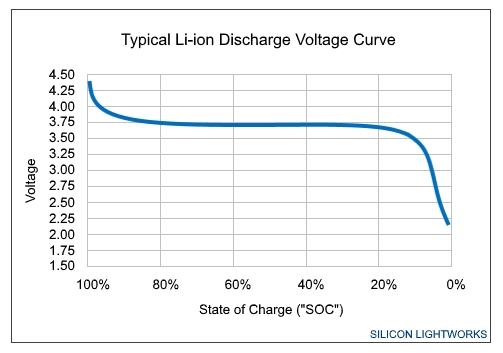

Yes the 18650 will not be able to provide 4.5 to 5.5 V and the data sheet characterises the parameters of the WS2812 at these voltages. It gives the absolute lower limit on working voltage at ~3.5V, the ~ meaning "about". So it will work at lower than 4.5V, but note here that the driving signal from say an Arduino should not exceed this. This means it is advisable to drive the Arduino with the same power supply as the LED strip.
This has the problem that an Arduino like the Mega and Uno is not guaranteed to work at 16MHz at a lower voltage than about 3.7V.
Now a battery like the 18650 will typically discharge like this:-
You will see it starts fresh at just over 4.3V, spends most of its time at 3.7V, and then drops off. You must not let the battery discharge below 3V or it will become damaged. Some batteries claim to be "protected" against this.

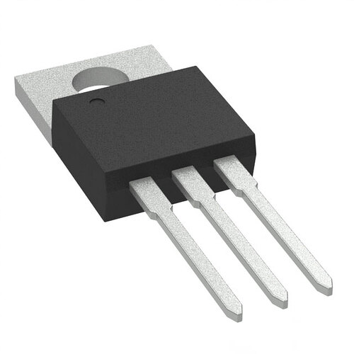

OK! So I got 2 18650 batteries (INR 18650). Putting them in series gives me about 7.4VDC. Can use a voltage regulator or a voltage divider to drop the voltage to about 5VDC? I believe someone calculated that I will be pulling 3.3A. I found this:
Is it that simple to just drop the voltage and make it work? I'd have the volts, and the amps sooo... it should work, right? I'm worried I'm missing something since no one has suggested it. And even you have said that 1 is not enough and 2 is too many but didn't mention a voltage regulator to drop the voltage. What am I missing here?

Yes you need to drop the voltage.
No you can’t use a voltage divider it wastes far too much current about ten times the current you want to take from it.
Using a voltage regulator converts the excess power into heat, so a lot of battery power is wasted.
The most efficient thing to use is a buck converter, but at these sort of currents these are also the most expensive option.
