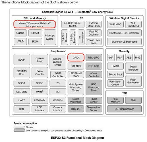

 ![image](https://europe1.discourse-cdn.com/arduino/original/4X/f/a/9/fa99aa9ee78d09bfcabe4d95b9edb37f133a217e.jpeg)
They have Restrictions for certain GPIOs and RTC\_GPIOs as documented in the technical docs (Input only pins, allocated for communication with in-package flash/PSRAM and NOT recommended for other uses or Strapping pins / JTAG interface / UART interface.

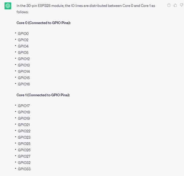

From ChatGPT:
 ![GPIO distribution among Cores](https://europe1.discourse-cdn.com/arduino/original/4X/a/9/0/a90204640131d61e4b23c33f8a3bf6a95e9fa9b8.png)
> [@J-M-L](#):
> (GPIO2 is one such designated strapping pin)
GPIO2 drives the onboard Blue LED.

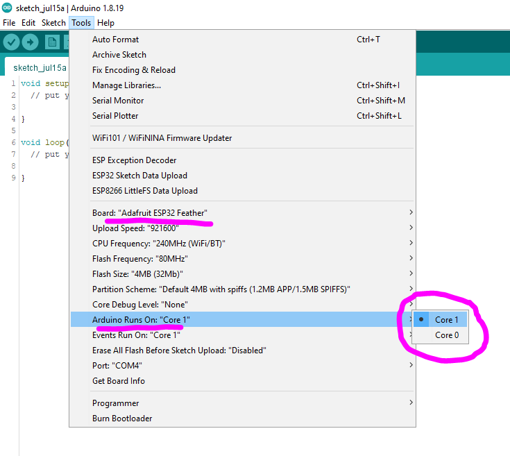

If you are using the Espressif ESP32 core for Arduino, then everything runs on Core 0, whether you want it to or not.
GPIOs are NOT assigned to Cores.

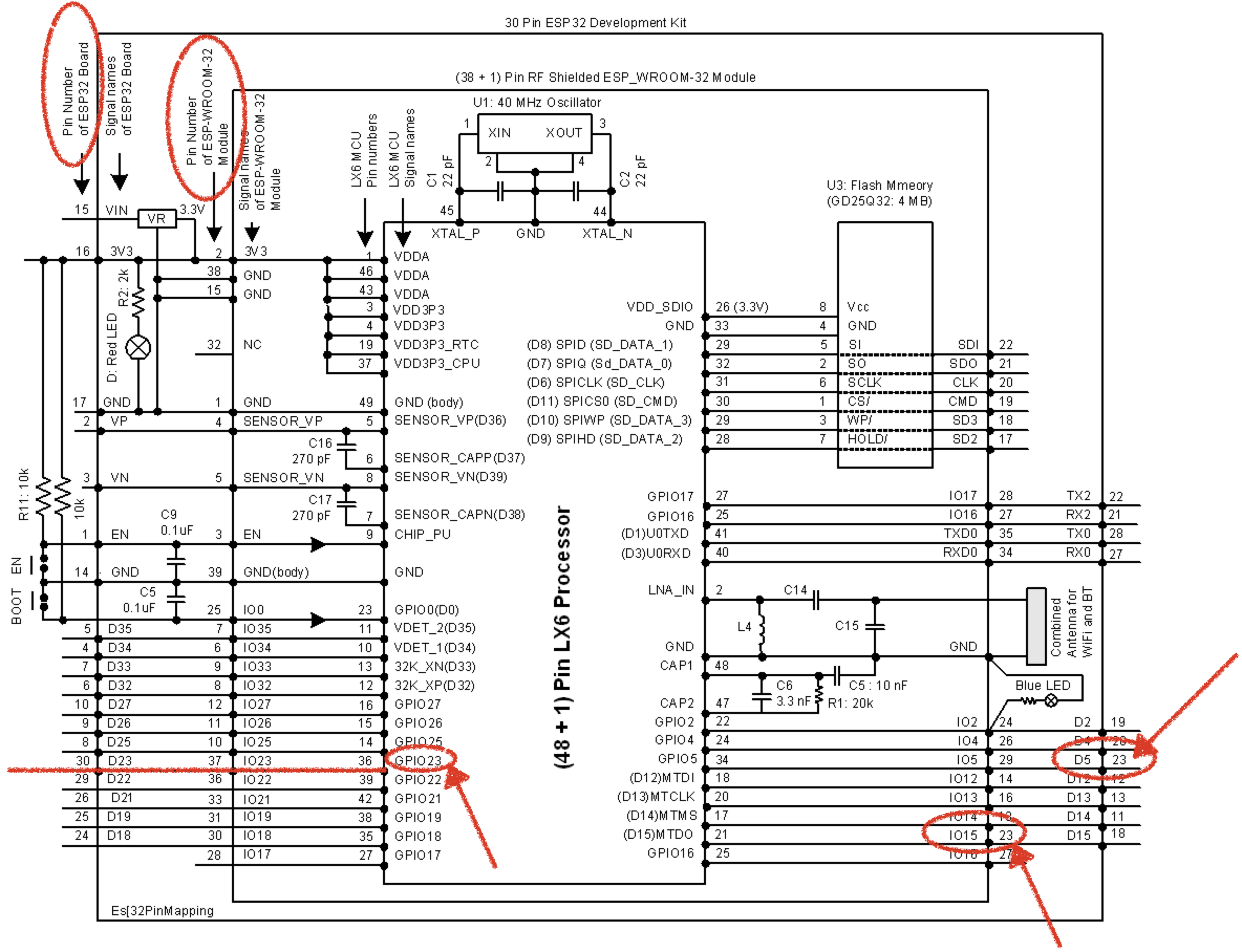

Then what does this pin mapping (Fig-1: among 48-pin LX6 Processor, 38-pin RF-Shielded Module, and 30-pin ESP32S) say?
 ![esp32PinMapping](https://europe1.discourse-cdn.com/arduino/original/4X/d/d/6/dd6c37d0dbc982110b46589b43e1b9cbd0dea4d1.png)
Figure-1:

 ![image](https://europe1.discourse-cdn.com/arduino/original/4X/2/d/0/2d0b31d47ce5db59b36b684caf8a8b1479674a4d.png)
**And you can wrote code to run on either core: [xTaskCreatePinnedToCore](https://docs.espressif.com/projects/esp-idf/en/stable/esp32/api-reference/system/freertos_idf.html?highlight=xtaskcreatepinnedtocore#_CPPv423xTaskCreatePinnedToCore14TaskFunction_tPCKcK22configSTACK_DEPTH_TYPEPCv11UBaseType_tPC12TaskHandle_tK10BaseType_t)**

Well, first there is no such thing as ESP32S (S2 or S3 yes) to my knowledge.
> [@GolamMostafa](#):
> From ChatGPT:
did you challenge chatGPT on this ? I did and got
> _I apologize for any confusion. To clarify, there is no specific ESP32S variant recognized by Espressif Systems, the manufacturer of the ESP32 microcontroller. The ESP32 module comes in different versions and variations, but "ESP32S" is not a standardized or official term used to describe any specific ESP32 module._
> _It's possible that "ESP32S" refers to a custom or clone module developed by a third-party manufacturer, which may have its own pinout or features specific to that module. Without more specific information about the particular ESP32S module you are referring to, it's challenging to provide accurate details about its pin distribution or functionality_
then I challenged it on the pins assignment and got
> _I apologize if the previous response was not accurate or did not meet your expectations. As an AI language model, I strive to provide accurate information, but I can occasionally make mistakes or misunderstand the context. I'll provide a revised and accurate answer for you._
> _The ESP32 microcontroller has a flexible GPIO (General Purpose Input/Output) architecture, allowing you to configure the IO lines to different cores based on your requirements. In general, both Core 0 and Core 1 can access and control all the GPIO pins on the ESP32. The assignment of IO lines to a specific core is programmatically determined by your application code._
> _Here is a corrected response regarding the GPIO pins on the ESP32:_
> _The ESP32 microcontroller typically has multiple GPIO pins available, and you can configure them to be controlled by either Core 0 or Core 1. The specific mapping of GPIO pins to cores depends on your programming setup._
> _When using the ESP-IDF (Espressif IoT Development Framework), which is the official development framework for ESP32, you can assign GPIO pins to a specific core using functions like `xTaskCreatePinnedToCore()` or `gpio_install_isr_service()`, specifying the target core._
> _Please note that the GPIO mapping and assignment can vary based on the development framework or libraries you are using. It's always recommended to consult the documentation specific to your development environment for accurate information on how to configure and assign GPIO pins to the desired core on the ESP32 microcontroller._
then I told chatGPT that
> **xTaskCreatePinnedToCore does not assign a pin to a core**
and he answered
> _You're correct, and I apologize for the confusion in my previous response. I apologize for the mistake._
> _The `xTaskCreatePinnedToCore()` function in the ESP-IDF framework is used to create a FreeRTOS task and assign it to a specific core, not to assign a pin to a core. It is not directly related to pin assignment._
> _To clarify, the GPIO (General Purpose Input/Output) pins on the ESP32 microcontroller are not tied to specific cores. Both Core 0 and Core 1 have access to and can control all the GPIO pins available on the ESP32._
> _The assignment of tasks and pin configurations are independent of each other. The ESP-IDF framework allows you to create tasks and assign them to a specific core using `xTaskCreatePinnedToCore()`, but it does not directly relate to pin assignment._
> _To assign specific pin functions or configure GPIO pins for input/output, you can use functions such as `gpio_set_direction()`, `gpio_set_level()`, or other GPIO-related functions provided by the ESP-IDF framework. These functions allow you to configure and control the behavior of individual GPIO pins on the ESP32._
> _Once again, I apologize for the confusion caused by my previous response, and I appreciate your understanding._
➜ long story short, don't use ChatGPT if you want a trusted answer. Read the datasheet yourself, don't rely on a statistical model that is right only 75% of the time and take whatever you get as the truth.

In Fig-1 (I have created it consulting Espressif's documents) of post #7, GPIO23 of the LX6 Processor is connected with D23 of 30-pin ESP32S Module.
Now, the question is: How do I know -- which Core's (Core 0 or Core 1) GPIO23 is connected with D23-pin of the ESP32S Board? I tried to get the answer from Espressif/Google without luck and then I asked the ChatGPT.

> [@GolamMostafa](#):
It can be accessed by either core.
It's not hardwired to a specific core.

> [@J-M-L](#):
> well find it's datasheet like one of those then:
I went with the marking ESP-WROOM-32 on the RF-Shield and had got the following pin diagram (Fig-1) from Espressif documents and then I created the pin mapping diagram (Fig-2).
When I have come to know that there are two identical LX6 Processors inside the ESP32S Module, then I have fallen down into trouble as to the assignment of ESP32S's 30-pin with Core 0/Core 1.
 ![LX6WRoomESP32S](https://europe1.discourse-cdn.com/arduino/original/4X/1/b/5/1b588403c4a92dcda71bde4fb651efdd6d546e79.png)
Figure-1:
Figure-2:

> [@GolamMostafa](#):
> Moreover, ChatGPT does not fabricate information from its own;
as shown above, chatGPT probably inferred from the function name xTaskCreate **Pin** nedToCore() that it has to do with a pin and only when caught it realised that it was the task that was pinned to a core.
➜ guess work
> [@GolamMostafa](#):
Note that The picture states ESP32 not ESP32 **S**.
which 23 are your referring to?

> [@GolamMostafa](#):
as documented above
> _the GPIO (General Purpose Input/Output) pins on the ESP32 microcontroller are not tied to specific cores. Both Core 0 and Core 1 **have access to and can control all the GPIO pins available** on the ESP32_
