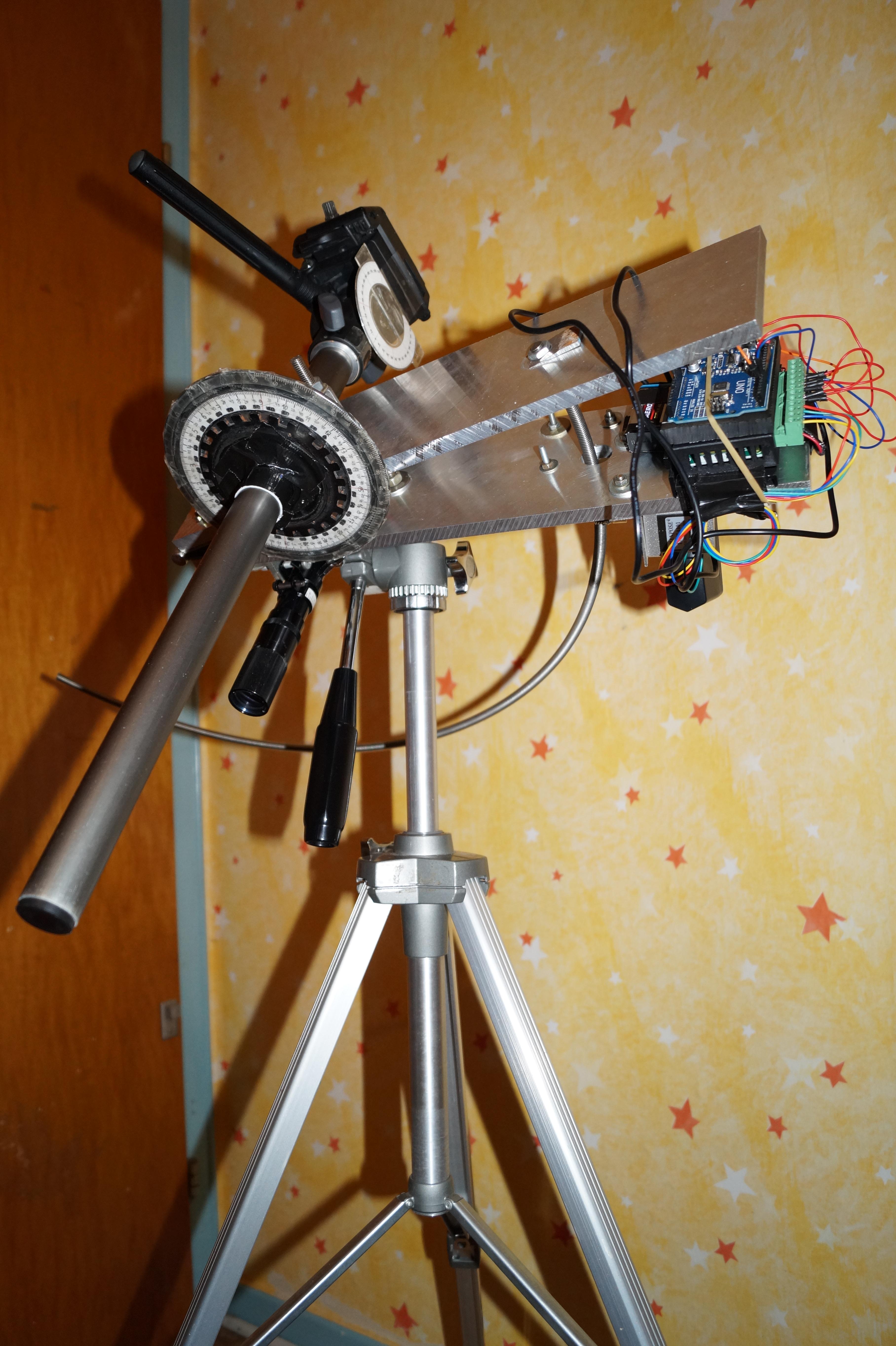

Hi there,
I have constructed a barndoor for tracking stars using an arduino UNO clone and a tb6600 driver. It works fine but the thing is, I always have to upload one program for the stepper to go in one direction and one for the opposite direction (to bring the barndoor back into default position). I would like to be able to do at least three tasks with the stepper without having to connect to the board and upload the respective program each time for each task: 1. On/Off button 2. stepper going in one direction 3. stepper going in the other direction. Perhaps a fourth one for different speed.
from what I have read you can only upload one sketch to the board but still use different parts of the sketch for different tasks. So my question is: can I do this via buttons that are connected to the board (and different pins) and if so, how? I.e. which kind of buttons / cables / pins, preferably at the least costs possible. I believe I can do the programming, so my question is probably only hardware related. I guess there would also be the need of first turning off all other buttons before turning on a specific button. Maybe there are buttons that allow to do this in one go, i.e. pressing one button means turning off all other buttons?

The usual way is to have several functions in the program which are called when different things need to happen.

A simple Switch.
Anything you might have laying around.
If( switch == high)
run forward
Else
Run reverse
This is not actually code but shows how simple it is

Buttons are cheap. Just get one at your local hardware shop. All they have to do is make and break an electrical contact, just about any button will do just fine. Find one that you like.
ok thanks guys, sounds simple :slight_smile: just googled a little, how about a TTP224 (has 4 buttons), I suppose that item would do the job?

That's routine. Press button once, do one thing. Press it again, stop doing that thing (or do something else). Those touch sensors make that easy as you don't have to worry about button bounce.
Do look up the finite state machine programming technique. This is one of many many examples. Only some of the simplest projects that I've built do not use a state machine of sorts. More complex projects tend to have many independent and/or nested state machines in the same sketch.

I'm using a Sony SLT-A58, the camera itself doesn't cause any problems especially because I use a remote and the selftimer. The barndoor though is pretty susceptible to vibrations, especially because I didn't cut off much of the rod. So any vibration I cause to the apparatus can last for quite some time, don't know exactly for how long as I've only used the barndoor a couple of times and under bad weather conditions (windy up to 25 km/h, not completely clear sky). But I noticed and also could see in the live-view that when I touched the apparatus or a gust of wind came by the rod would swing and that's not so good :smiley: But when I wait enough time (and it's not so windy) it stops swinging. Reducing that time by using touch switches instead of button switches is therefore helpful. The stepper does not seem to cause noticable vibrations as I use microstepping and rubber damping.
I have ordered the ttp224 and some cables, will see how it works out.

yeah, LEDs are helpful, the two arduino LEDs shine constantly. perhaps I should put some LEDs near the polar scope as well since I have at least three times mistaken it for the tripod handle :smiley: ... and that's not so good because I would have to disassemble almost the complete apparatus to be able to realign it with the axis of the hinge.
my setup looks like this (see attachment)
