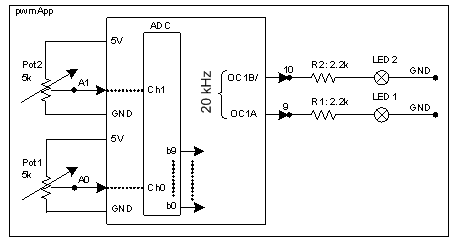

**Author:** ![GolamMostafa](https://dub1.discourse-cdn.com/arduino/user_avatar/forum.arduino.cc/golammostafa/32/239011_2.png) [@GolamMostafa](https://forum.arduino.cc/u/GolamMostafa)\
**Post date:** [July 1, 2022, 11:57am UTC](https://forum.arduino.cc/t/how-to-achieve-to-pwm-maximum-frequency-and-variable-duty-cycle-of-at-least-8-bit/1008050/14 "2022-07-01T11:57:33Z")
</div>
> [@guillemdc](#):
> I have a stereo tremolo in which I'd like to treat each side slightly differently to create panning effects.
**Sketch** for 20 kHz signals at DPIn-9 (Ch-A) and DPin-10 (Ch-B inverting) using 16-Bit TC1 in Fast PWM-14. Duty cycle for Ch-A and Ch-B can b varied with Pot1 and Pot2 respectively of Fig-1. (LED1 and LED2 are just for testing purpose of the functioning of the PWM signals by lowering down the frequency to 1 or 5 Hz.)
```arduino
#define OC1A 9
#define OC1B 10
  pinMode(OC1A, OUTPUT); //Ch-A
  pinMode(OC1B, OUTPUT); //Ch-B
  TCCR1A = 0x00; //reset
  TCCR1B = 0x00; //TC1 reset and OFF
  //fOC1A = clckSys/(N*(1+ICR1)); Mode-14 FPWM; OCR1A controls duty cycle
  // 20 kHz = 16000000/(8*(1+ICR1)) ==> ICR1 = 99, N = 8
  TCCR1A |= (1 << COM1A1) | (0 << COM1A0); //Ch-A non-inverting, Mode-14
  TCCR1A |= (1 << COM1B1) | (1 << COM1B0); //Ch-B inverting
  TCCR1A |= (1 << WGM11);
  TCCR1B |= (1 << WGM13) | (1 << WGM12); //Mode-14 Fast PWM
  ICR1 = 99; //changes frequency as ICR changes
  OCR1A = 50; //~= 50% duty cycle
  OCR1B = 50;
  TCCR1B |= (1 << CS11); //N = 8
  OCR1A = map(analogRead(A0), 0, 1023, 90, 5); //duty cycle: 905 to 5%
  OCR1B = map(analogRead(A1), 0, 1023, 90, 5); //duty cycle: 905 to 5%
![pwmApp-1](https://europe1.discourse-cdn.com/arduino/original/4X/a/1/0/a10586f52c6e169c8c79430f3ed01f348625320b.png)
Figure-1:
