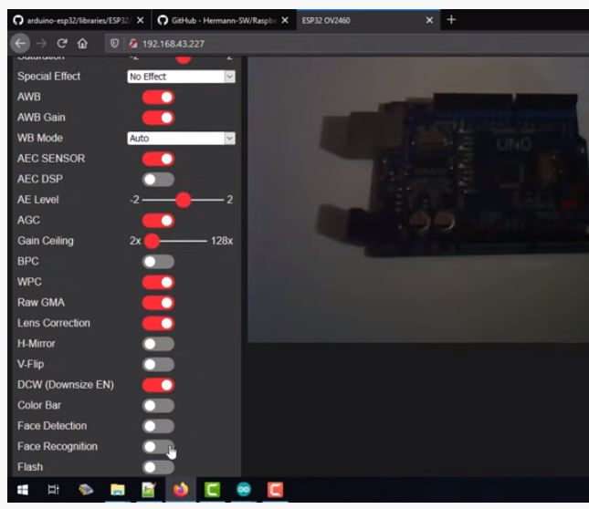

The ESP32CAM AP sketch shown camera image in phone OK, question is how to add a button on phone which make voice ('A pressed') when pressed.
the sketch included two subs, don't how to post.
The attached picture shown a interface to operate the ESP32CAM, say the last button Flash which can control the LED flash on camera.
Can I added a button and got a SOUND when pressed?
Thanks
Adam

Yes, it's technically possible to add a button to the existing Web Server. Is it easy... No... not for a beginner.
That example contains some pretty advanced coding and changing it is not something that I would attempt unless you really know what you are doing. The main HTML for the page is compressed/encoded... all you get is bunch of HEX - it's not easy to update.

actually I did added and edited button from HTML code, my question is how to get HTML page speak out the sentence in ESP32CAM?
The ESPCAM boards that I am aware do not have any audio capability, although there may be some around.
I guess you could always hook up an external amplifier and play pre-recorded sound. Check out this example
Thank for the solution.
yes, the ESP32 don't have audio, what I was thinking is use (html + js) generate audio which is so easy in HTML page, but hard when used in ESP32, decode audio file into base 64, these be able to load file now, but my ESP32 keep crash, do't know why?
the reason make things complex is what I like to have is let my phone speak instead of the ESP32 speak itself.
Ah I see... so you want the web page to "speak".. not the ESP32.
That is something quite different.
This may help [Solved] Play audio on website - ESP32 Forum
Thank you red_car.
I'll dig it and see.
