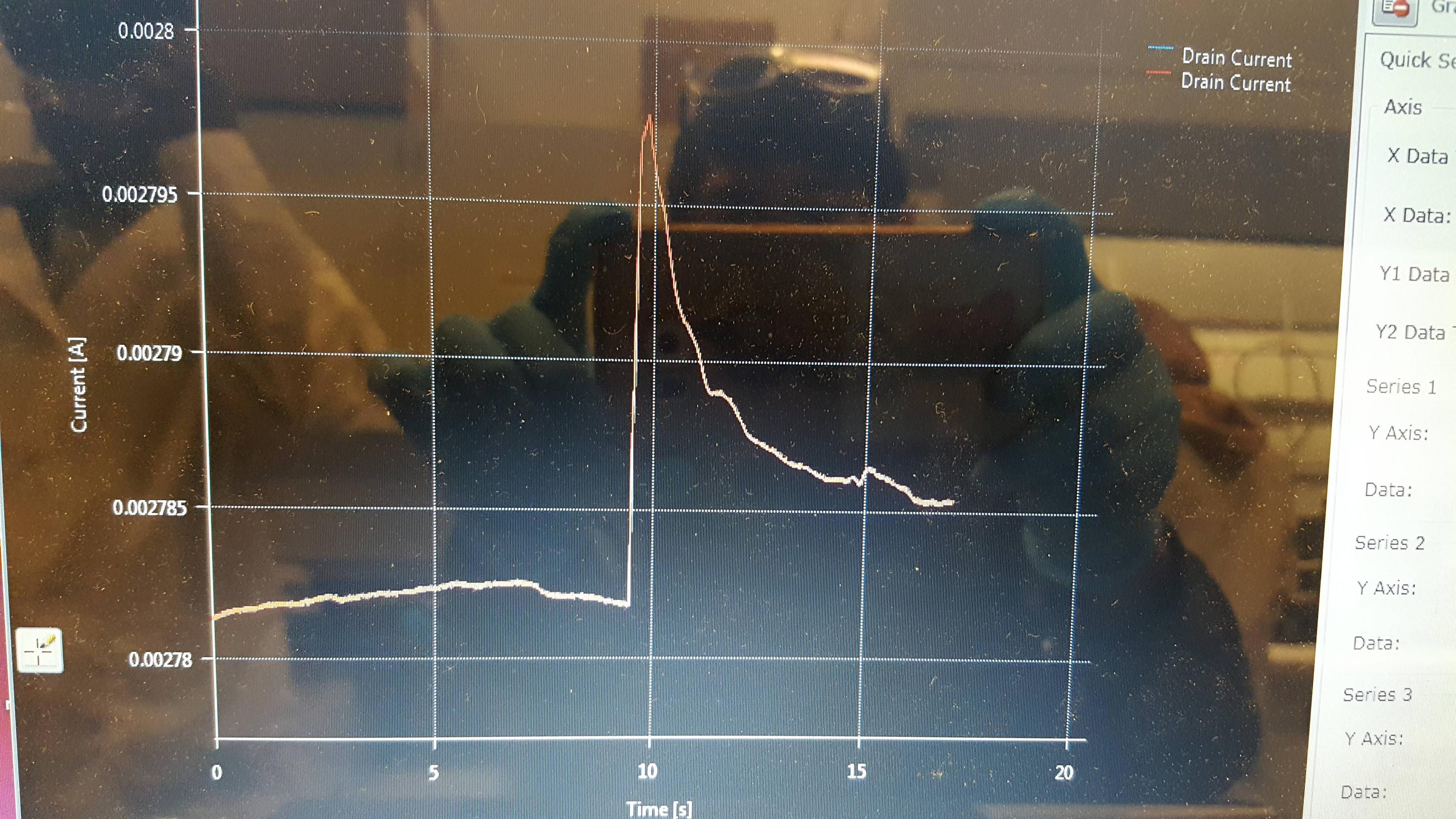

Hi, SMU is a source measurement unit used in our laboratory. The SMU measures the change in current when we apply the analyte. Below is how it looks like when it is tested in my lab SMU.
What I am trying to do is to get the same graph as the one in SMU (with a smoother curve or higher resolution) in arduino, instead of having a graph like this.The connection in the arduino is a change of 40 uA across a 1K resistor.
From the info you have provided, the sensor acts roughly as a 480 Ohm resistor in the absence of analyte, decreasing to about 462 Ohms in the presence of analyte.
Such a change could be monitored by Arduino using a Wheatstone resistance bridge and associated amplifier, similar to how strain gauges or load cells are read out.
Google "arduino strain gauge amplifier" for lots of tutorials on that topic. The HX711 amplifier/ADC and three 470 Ohm resistors might work.
