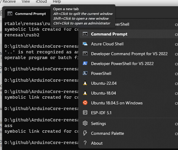

I don't have it fully building a sketch yet with the github code... But getting closer.
Note I am running windows 11.
What I have done so far:
I found you need to clone the project recursively:git clone --recursive GitHub - arduino/ArduinoCore-renesas
That was not unexpected. But then found there were some form of Sybolic links built into the project. That were showing up as a file that only contained a relative pathname to a another file or directory... Several internet searches later found, I probably needed to reinstall git and enable one of the advanced options for symbolic links... So installed 2.41....
One of the places I saw mentioned maybe telling the clone to enable symbolic links.
So I recloned again:
git clone --recursive -c core.symlinks=true GitHub - arduino/ArduinoCore-renesas
This failed:
remote: Total 12483 (delta 1206), reused 1215 (delta 1197), pack-reused 11224
Resolving deltas: 100% (7519/7519), done.
error: unable to create symlink cores/arduino/api: Permission denied
error: unable to create symlink cores/arduino/tinyusb/class: Permission denied
error: unable to create symlink cores/arduino/tinyusb/common: Permission denied
error: unable to create symlink cores/arduino/tinyusb/device: Permission denied
error: unable to create symlink cores/arduino/tinyusb/host: Permission denied
error: unable to create symlink cores/arduino/tinyusb/osal: Permission denied
error: unable to create symlink cores/arduino/tinyusb/rusb2: Permission denied
error: unable to create symlink cores/arduino/tinyusb/tusb.c: Permission denied
error: unable to create symlink cores/arduino/tinyusb/tusb.h: Permission denied
error: unable to create symlink cores/arduino/tinyusb/tusb_option.h: Permission denied
error: unable to create symlink libraries/ESPhost/src/protobuf-c/protobuf-c.h: Permission denied
error: unable to create symlink libraries/FATFilesystem/diskio.h: Permission denied
error: unable to create symlink libraries/FATFilesystem/ff.c: Permission denied
error: unable to create symlink libraries/FATFilesystem/ff.h: Permission denied
error: unable to create symlink libraries/FATFilesystem/ffconf.h: Permission denied
error: unable to create symlink libraries/FATFilesystem/ffunicode.c: Permission denied
error: unable to create symlink libraries/LittleFilesystem/lfs.c: Permission denied
error: unable to create symlink libraries/LittleFilesystem/lfs.h: Permission denied
error: unable to create symlink libraries/LittleFilesystem/lfs_util.c: Permission denied
error: unable to create symlink libraries/LittleFilesystem/lfs_util.h: Permission denied
error: unable to create symlink libraries/WiFiS3/src/WiFiCommands.h: Permission denied
Updating files: 100% (1565/1565), done.
More search found, I need to change my user settings to enable developer mode.
I redid the same clone and this time that worked.
Note: I found I had to redo the core\arduino\api link as to how and where I cloned things to.

Hi @KurtE.
Overview
The technique used by Arduino's boards platform developers is to install the development version of the platform under a uniquely named vendor folder (e.g., arduino-dev) under the hardware subfolder of their sketchbook folder, and then install the latest release version as usual via Boards Manager.
Install Development Version of Platform
Since you mention mklink, I'll assume you are using PowerShell:
  1. Click the Windows "Start" button.
  2. Type powershell in the search field.
  3. Right click on the "Windows PowerShell ISE" entry from the search results.
    A context menu will open.
  4. Select the "Run as administrator" from the context menu.
    A "Windows PowerShell ISE" window will open.
  5. Type the following command at the PowerShell command prompt:
    cd "<sketchbook path>"
  6. Replace <sketchbook path> in the command with the path to your sketchbook folder (as set in the "Sketchbook location" field in the Arduino IDE preferences).
  7. Press the Enter key.
  8. Type the following command at the PowerShell command prompt and press Enter:
    mkdir hardware/arduino-dev
  9. Type the following command and press Enter:
    cd hardware/arduino-dev
  10. Type the following command and press Enter:
    git clone --recurse-submodules https://github.com/arduino/ArduinoCore-renesas renesas
Fix Symlinks
For some reason Windows is not recognizing the paths of some of the symlinks in the core. I haven't been able to find any good fix for that so we will have to resort to recreating them:
  1. Type the following command and press Enter:
    cd renesas/cores/arduino/tinyusb
  2. Type the following command and press Enter:
    rm class
  3. Type the following command and press Enter:
    New-Item -ItemType SymbolicLink -Path "class" -Target "../../../extras/tinyusb/src/class/"
  4. Type the following command and press Enter:
    rm common
  5. Type the following command and press Enter:
    New-Item -ItemType SymbolicLink -Path "common" -Target "../../../extras/tinyusb/src/common/"
  6. Type the following command and press Enter:
    rm device
  7. Type the following command and press Enter:
    New-Item -ItemType SymbolicLink -Path "device" -Target "../../../extras/tinyusb/src/device/"
  8. Type the following command and press Enter:
    rm host
    New-Item -ItemType SymbolicLink -Path "host" -Target "../../../extras/tinyusb/src/host"
    rm osal
  11. Type the following command and press Enter:
    New-Item -ItemType SymbolicLink -Path "osal" -Target "../../../extras/tinyusb/src/osal/"
  12. Type the following command and press Enter:
    rm rusb2
  13. Type the following command and press Enter:
    New-Item -ItemType SymbolicLink -Path "rusb2" -Target "../../../extras/tinyusb/src/portable/renesas/rusb2/"
Install ArduinoCore-API
Although much of the implementation of a core is architecture-specific, the standardized core API and the hardware independent components should be the same for every Arduino platform. In order to free platform authors from the burden of individually maintaining duplicates of this common code, Arduino has published it in a dedicated repository from which it may easily be shared by all platforms.
The arduino/ArduinoCore-renesas project leverages this arduino/ArduinoCore-API repository so you must install it as well. Since you might want to use it in multiple manually installed platforms, it is convenient to clone the repository to a centralized location and then make symlinks of it in each of the platform installations.
  1. Type the following command at the PowerShell command prompt:
    $Env:REPOSITORIES_PATH = "<repositories path>"
  2. Replace <repositories path> in the command with a convenient path to store the shared clone of the arduino/ArduinoCore-API repository.
  3. Press the Enter key.
    git clone https://github.com/arduino/ArduinoCore-API "$Env:REPOSITORIES_PATH\ArduinoCore-API"
    rm renesas/cores/arduino/api
    This is done to remove a symlink the Arduino developers created that targets an poorly chosen location for the arduino/ArduinoCore-API repository.
    New-Item -ItemType SymbolicLink -Path "renesas/cores/arduino/api" -Target "$Env:REPOSITORIES_PATH\ArduinoCore-API\api"
Install Toolchain
You now have a complete installation of the platform, but the toolchain (GCC, BOSSA, etc.) is not part of the platform.
The convenient way to install the toolchain is Boards Manager. Usually the toolchain that is installed with the latest release version of the platform will be suitable for use with the development version of the platform as well.

I'm sorry to hear that. Make sure to start GitHub Desktop by right clicking on the icon and selecting "Run as administrator" from the menu whenever you are planning to do some operation in the ArduinoCore-renesas repository. If you do that, the problem of the fallback behavior of adding normal text files in place of the symlinks should not occur.
I also never use PowerShell. I actually found it quite painful to write the PowerShell-based instructions I shared earlier in this thread. If you are looking for something more capable than cmd, I highly recommend Git Bash. You already have it installed on your computer as part of the Git For Windows installation.
I keep forgetting to try using it. I normaly have Terminal installed on my taskbar, where I can launch several different types of command prompts:
Which is pretty nice.
Maybe should add new profile
