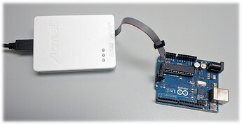

### 2.1 Flash bootloader `ATMega4809`
I can't see a connector for my `Atmel-ICE` or `AVR ISP mkII`, which I usually use to flash bootloaders. In comparison, the Arduino Uno and Leonardo have an `ICSP` connector at the bottom for that:
 ![image](https://europe1.discourse-cdn.com/arduino/original/4X/2/6/8/268a020b9893ac8701a4a5dfe3aabdf0c837c39a.jpeg)
However, the **Nano Every** doesn't have such a connector. There is a 6-pin connector at the bottom (just copper dots, no pins), but that one seems to be connected to the `SAMD11U` MCU.

> [@kristof\_mulier](#):
It's connected to both. The pinout is shown on the "full pinout diagram" you can download from the "Documentation" tab of the Nano Every product page.
 ![Clipboard01](https://europe1.discourse-cdn.com/arduino/original/4X/9/0/b/90b640e163518de418e604da037737380c987c43.png)

Nano every doesn’t use a bootloader.
The samd11 actually contains chip-programming firmware.

1. see my first coment to a UPDI programmer and Per's link to pinout of the 6 dots
2. the SAMD11 has a bootloader to replace the firmware.
additional link to firmware update
