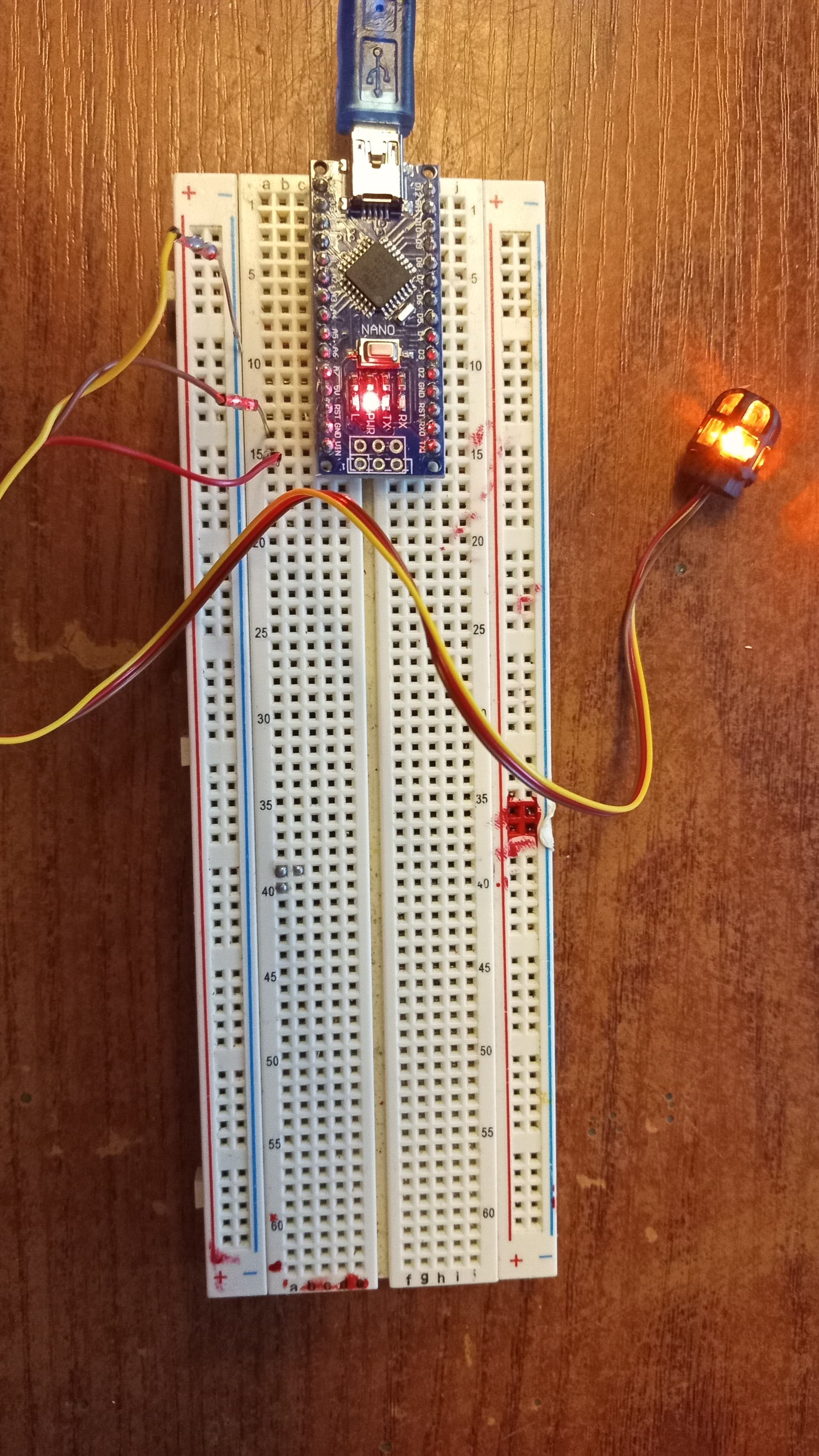

So have an Nano here USB powering a 5 LED device that has 3 or 4 additional modes that are supposed to be controlled by the YELLOW wire which I do not have connected. That yellow wire is supposed to be connect to a Radio Control (RC) channel to change the modes, a PWM channel I believe. Can I changed the modes with my Nano? Please help.
See the Servo Sweep example in the IDE.
If we read between the lines, it looks like treating the device as a servo and writing different angles to it might change the modes.
A simple sketch to write angles from 0 to 180 in steps of ten degrees with a two second pause between each step might change the modes, no harm to try.
Use a 220 ohm resistor in the signal line to the "servo".

I will try it. Thank you.
Servo Sweep worked! It goes through the 4 modes and then turns off and repeats. Check it out:
So, I guess all I have to do is put the momentary switch on pin 9 and I am set? Or do I have to speed that delay up?

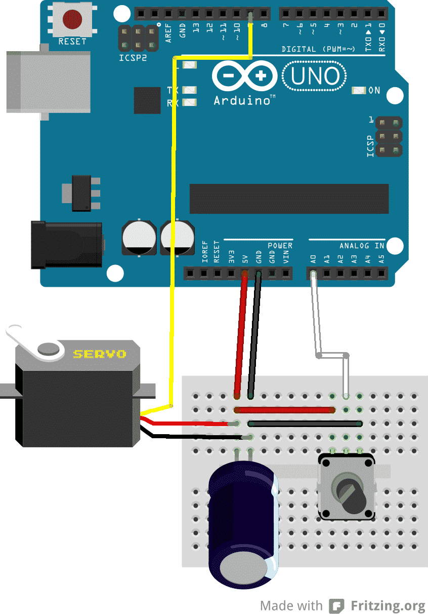

Found a 10k POT just tell me what to do with it to check those values please:
alto777 can you help me? I have a pot and want to connect it to figure out the angles for modes. Please let me know.
I can't write the sketch for you now. Can you make sense of this I found googling?
All you need to do to get the magic numbers is or t the value of pos in the code that you will find there.
You might google
arduino potentiometer control servo
to see other explanations, they'll all have about the same simlpe code.
a7
Ok I think I got it and what do to do, I will report back in a bit or by tomorrow. Thank you for replying.
Hi Alto, my 10k pot is hooked up and my "servo" is connected:
I just need to run a code to read the values of the pot connected. So what code should I run, I've seen a few...
Look through the link in #21.
There's exactly code except it does not print the value of the potentiometer.
Add printing to it.
