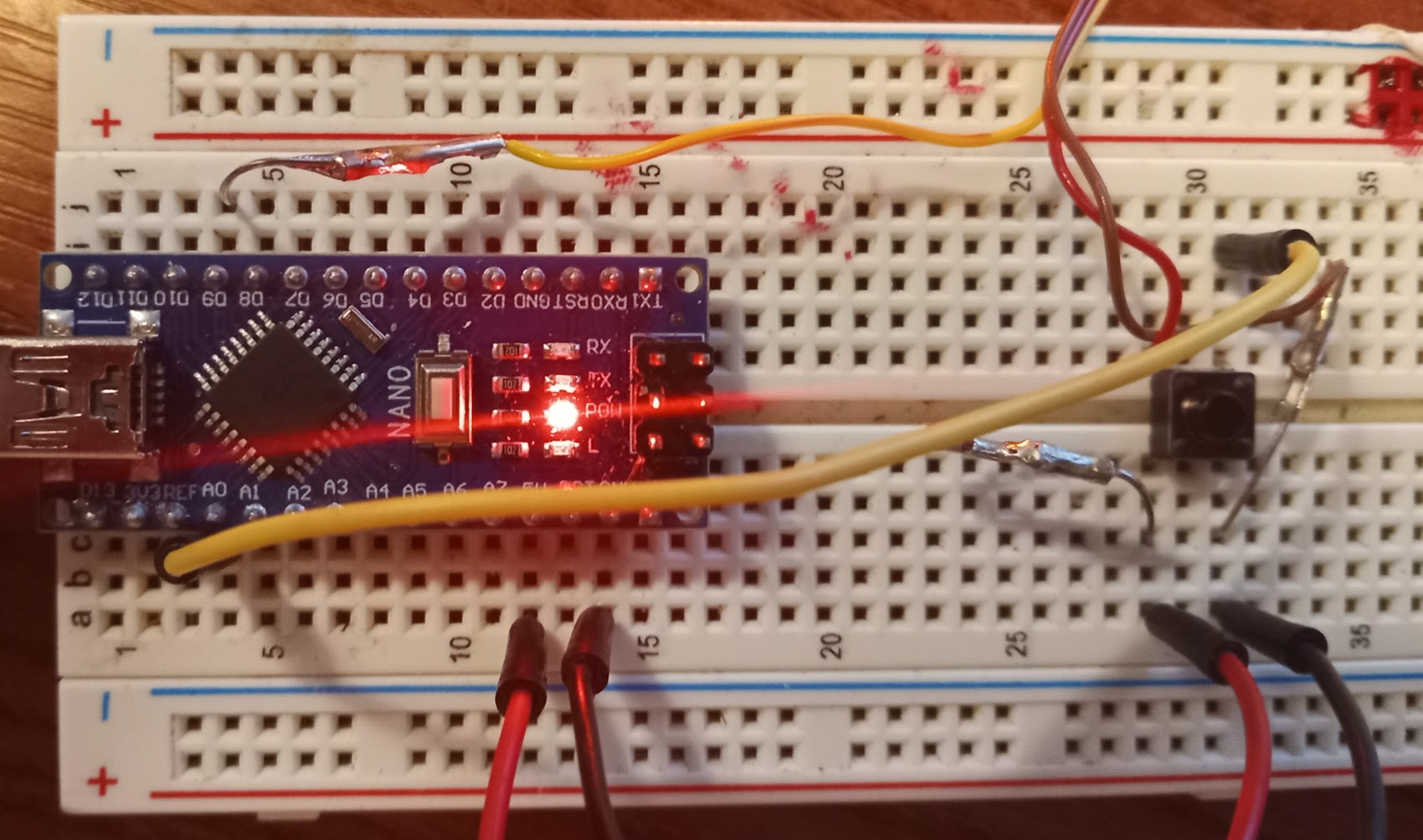

Alto,
I have uploaded your code and added button ( I think correctly ).
Here is pic of current build:
Serial Printer says "I see that button!!"
When I press it though, mode does not change. LED turns off briefly as if USB was disconnected and reconnected really quick. What are you thoughts?
Fixed button wiring:
Now TX blinks really quick once with one push of button, but no mode change for LED.
i think not!
Use only two pins on the pushbutton, either pair of diagonally opposite pins.
You are now shortening out and resetting the Arduino power supply which is a Bad Idea.
a7

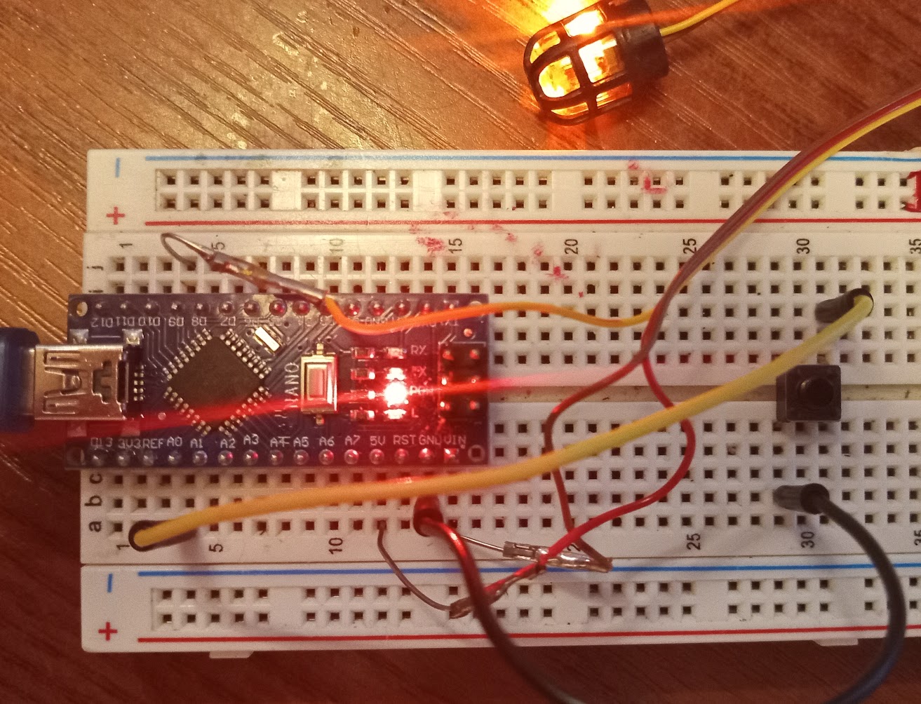

Fixed it. See #41.
Back when servo sweep worked, did the mode change once per sweep?
If you couldn't tell, add printing to that servo sweep code what worked and see if the mode changes once per sweep.
Make a longer pause between sweeps if it is still hard to tell when the mode changes.
I hope it changes once per sweep. If so doing it the way it is in the latest button-operated sketch should… also change the mode.
I got nothing if it is still not working.
It is less than desirable to power the LED thing for the Arduino 5+ pin, but it worked OK back when, so for now I don't suspect it as the root of the trouble ATM.
I'll try to think of another experiment. Just how, I think between the pot twiddling, which I can't remember if you ever got working smoothly, and the pushbutton, something should work.
Your wiring looks OK. But examine it closely again, make sure the wires are in the breadboard full and accurate &c.
Confirm one "saw that button" per button presss.
And what the what - to be thorough and it's easy enough, try changing the delay to 50 and then 20, but I dont think that should matter.
