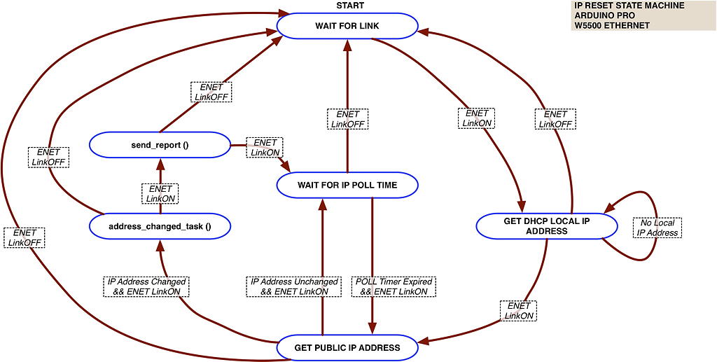

I've done this in the past. It worked to a degree, but this is a tricky area
Some pseudo-code in here - as it refers to project specific variables...
Call this when you initially startup, and again later if the network fails for any reason, call it again
bool usingDHCP, weWantoUseDHCP;
bool networkAvailable = false;
bool connect_to_network(void) {
  usingDHCP = false; // assume the worst
  if (weWantoUseDHCP) {
    Serial.print("DHCP... ");
    // DHCP timeout is set in Dhcp.h - note uppercase D
    if (Ethernet.begin(myMAC_address) != 0) {
      Serial.print("OK ");
      usingDHCP = true;
      Serial.print("not responding. ");
  if (!usingDHCP) {   // DHCP not in use, or failed to init
    Serial.print("Use STATIC IP... ");
    Ethernet.begin( myMAC_address, mySTATIC_IP, mySTATIC_NS, mySTATIC_GW, mySTATIC_NM);
  networkAvailable = true;
  return true;
Hi lastchancename.
Thanks for your reply, but it went a bit over my head :slight_smile: Not used to programming languagues so I probably did something wrong when trying to execute your suggestion.
I pasted the code above the void setup area without changing it, so I kinda got your pseudo code there (I'm basically not quite sure what to change it with, I'm way over my head with this).

hi im doing a project to check whether the ethernet is connected to arduino or not and to senda message to mobile phone about this status through GSM module. your post and coding really seems helpful. but it will be so much helpful if u give me the codings that u used finally to make the red LED glow if the ether net is not connected .I'm also not much familiar with coding.so help me with this.
I have commercially manufactured networked hardware that is not tolerant of the public IP address changing (and requires a reboot if it does). It is designed to work in a fixed IP environment and I needed it to operate reliably in a DHCP environment. The following code will detect the ethernet cable being detached and a change in the public IP address. Stubbed functions are available for acting upon the acquisition or change in the public IP address. I use the stubbed methods to assert a RESET to the target device and then post data to a log that resides on a MySQL database table through a web page (located on the local network and behind the firewall). I'm using a W5500 board that is hardwired to an Arduino PRO (i.e. not a shield), and this works well. Feel free to use this as you please.
Source code uses 4-character tab stops.
EthernetHotPlugging.zip (17.8 KB)
codebits:
Here's a state machine diagram for the above posted code...
BTW, I would encourage the developer of the Ethernet library to fix the problem with the Ethernet.hardwareStatus () method not functioning correctly until after execution of Ethernet.begin ( mac ). If proper hardware status was available prior to invoking begin ( mac ), the 60-second blocking of execution could be avoided. This is a correctable situation.
