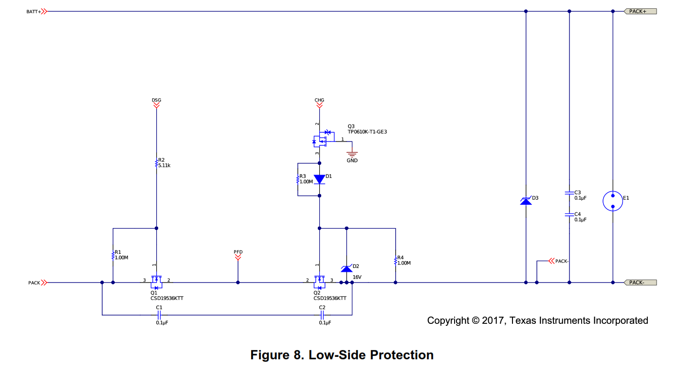

I've built the circuit for a 6S 3.7V battery management system (BMS) using a BQ7693003 and Arduino Nano. However, I'm encountering communication issues between the Arduino and the chip. Here's my schematic :
You need to connect the Nano to the BMS chip. The communications issues are due to this non-connection.
Please don't say that you have, I can see from your schematic that you haven't.

I see Vcc, SDA, SCL, REGOUT. I don't see....
Hi, @weha_rosyid34
You have Regout connected to Vin, this is not connected to the 5V of the Nano.
Vss is connected to gnd, correct.
Sda and Sdl appear correct.
What does the Regout OUTPUT from the BMS do, and why is it connected to the Nano Vin, power supply input pin?

RegOut is an OUTPUT from the IC.
RESRC is the Input, if you read the pin table.
Because the schematic you have supplied is Ti recommended circuit.
NOW reverse engineer your project and draw a schematic of YOUR project.

Thank you so much, Tom. Here is my schematic. But iam not done yet with the program and check the hardware. because i stuck on communicating arduino and bq76930.
bq769x0 BMS Configurations for Cordless Appliances-5-8.pdf (483.7 KB)
here is my refference by the way
