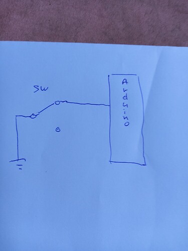

Hello,
I am in the process of making a remote control. I would like to connect 10 toggle switches (see image)
 ![Toggle switch](https://europe1.discourse-cdn.com/arduino/original/4X/1/d/3/1d3b634918ac83d3381a2604ba4bc6a9b9c6a488.webp)
to my arduino boards so that I have 10 separate digital inputs of 0 or 1. How should I connect these? Is that also with resistors? If so, how?
Thanks in advance!
Greetings Yorbe

Center pin to GND, one of the other pins to an Arduino pin. Use the built-in pull-up resistor.

Yes, but you have to use also the VCC right?

No, no VCC needed.

> [@yorbus](#):
It's there but it's connected through a resistor internal to the processor. See S3 in the diagram below.

It is VCC when you set pin mode to INPUT\_PULLUP
pinMode( pin, INPUT\_PULLUP );
that pin sources VCC through 20K to 50K resistance. It is very weak but it is VCC that you can safely ground. The pin reads LOW when grounded.
