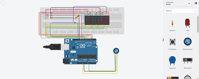

How to connect a potentiometer with an arduino and display its values onto a 4-7 segment displays (values from 0 - 1023)
I use the software Tinkercad so any help would be useful :slight_smile:

Exactly which 7-segment display do you have? Is it four individual digits with 8, 9, or 10 pins each? Is it four digits in a unit with 11, 12, or 13 pins? Are the digit pins Anodes (+) or Cathodes (-). Are the displays on a board with a driver chip? How are the pins on the board labeled?
they are 4 separate 7 segment display, have a common anode and are connected to pins 10,11,12,13
any help in the programming part would be useful

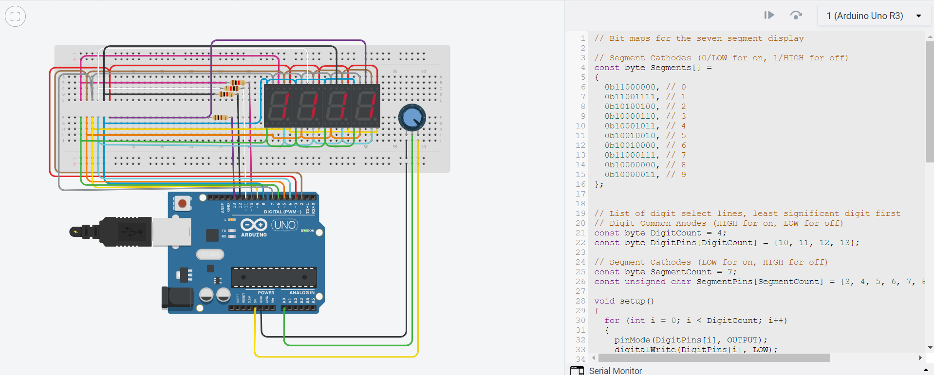

// Bit maps for the seven segment display
// Segment Cathodes (0/LOW for on, 1/HIGH for off)
const byte Segments[] =
  0b11000000, // 0
  0b11001111, // 1
  0b10100100, // 2
  0b10000110, // 3
  0b10001011, // 4
  0b10010010, // 5
  0b10010000, // 6
  0b11000111, // 7
  0b10000000, // 8
  0b10000011, // 9
// List of digit select lines, least significant digit first
// Digit Common Anodes (HIGH for on, LOW for off)
const byte DigitCount = 4;
const byte DigitPins[DigitCount] = {10, 11, 12, 13};
// Segment Cathodes (LOW for on, HIGH for off)
const byte SegmentCount = 7;
const unsigned char SegmentPins[SegmentCount] = {3, 4, 5, 6, 7, 8, 9};

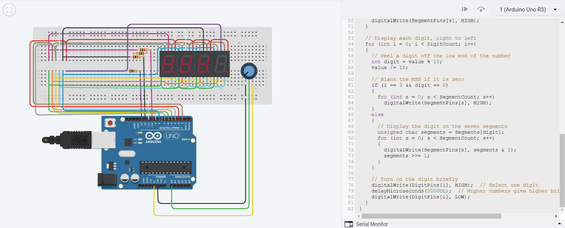

  for (int i = 0; i < DigitCount; i++)
    pinMode(DigitPins[i], OUTPUT);
    digitalWrite(DigitPins[i], LOW);
  for (int i = 0; i < SegmentCount; i++)
    pinMode(SegmentPins[i], OUTPUT);
    digitalWrite(SegmentPins[i], HIGH);
  int value = 9999;
  // Clear all segments before enabling a digit
  for (int s = 0; s < SegmentCount; s++)
    digitalWrite(SegmentPins[s], HIGH);
  // Display each digit, right to left
    // Peel a digit off the low end of the number
    int digit = value % 10;
    value /= 10;
    // Blank the MSD if it is zero
    if (i == 3 && digit == 0)
      // Display the digit on the seven segments
      unsigned char segments = Segments[digit];
        digitalWrite(SegmentPins[s], segments & 1);
        segments >>= 1;
    // Turn on the digit briefly
    digitalWrite(DigitPins[i], HIGH);  // Select one digit
    delayMicroseconds(3000UL);  // Higher numbers give higher brightness but more flicker
it just shows 1 1 1 1 on the 4-7 segment displays,
my main purpose is to show the potentiometer values (0-1023) on the 4 digit 7 segment displays
any help would be nice
Change:
int value = 9999;
to
int value = analogRead(A0);

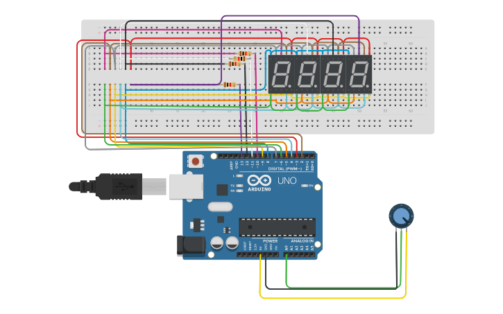

it shows this now :((
and when i turn the potentiometer it doesn't do anything
could u look at the wiring idk if there is a mistake but still?
thank you

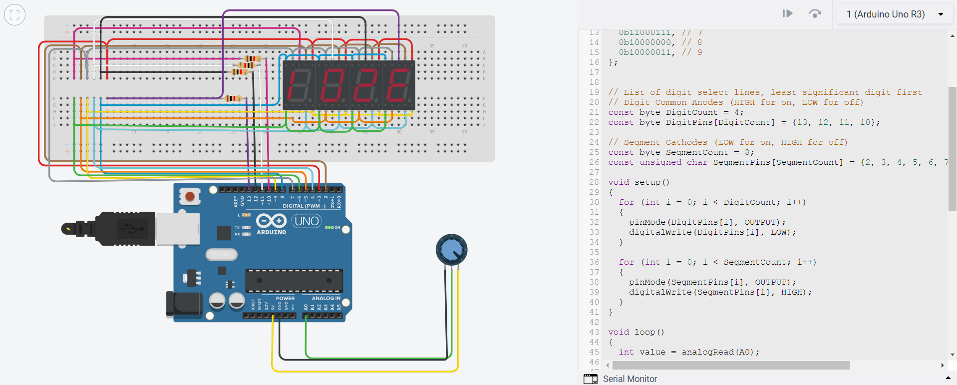

Maybe you were wrong when you said "common anode". Try changing:
to:
    digitalWrite(DigitPins[i], LOW);  // Select one digit
You should be wiring the displays similar to this.
Each segment needs a resistor.
Each digit needs a driver.

still is not showing values from 0-1023
try the link maybe?

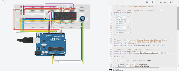

i brought the potentiometer down from the breadboard and it shows some digits but not completely, can you tell me why is this happening?
also this is the link if you could make changes to the code and the circuit
I would try reversing the order of the first 7 segment pins:
const unsigned char SegmentPins[SegmentCount] = {8, 7, 6, 5, 4, 3, 2, 9};
it workedd!! but i dont know why the numbers are upside down or in reverse????
i think we are very close :)))
