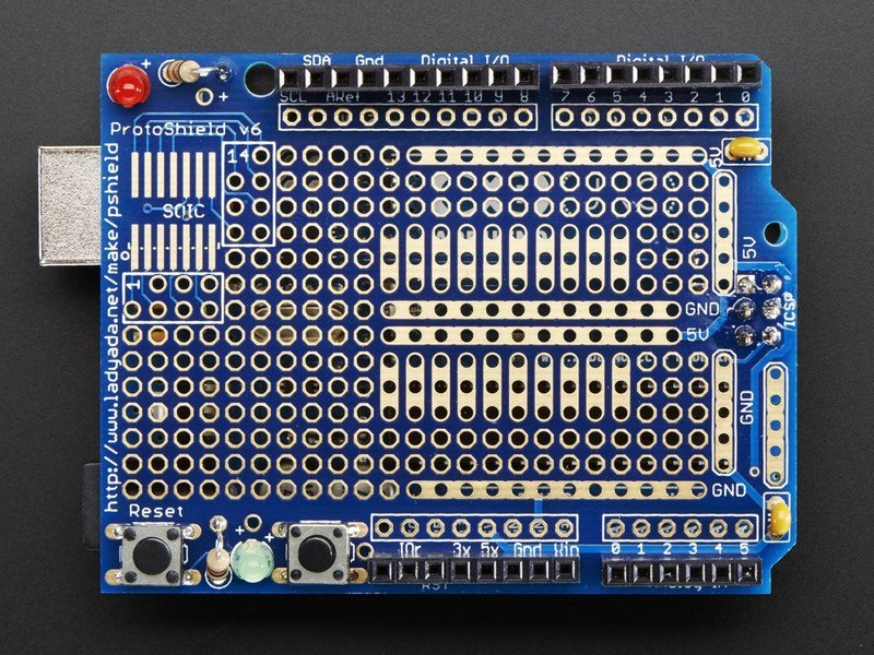

I was going to suggest a "proto-shield"
But I don't know if it can fix the problem with A4.
EDIT: hmmmm... maybe....

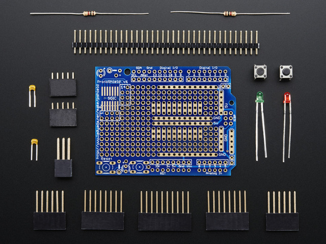

The proto shield comes with some female PCB header strips with long pins. You can see them at the bottom of this photo. You solder these into the proto shield so that you can then plug the proto shield on top of the Uno, then plug the TFT shield in top of the proto shield.
learn_arduino_2077-03
So maybe what you can do is solder those headers, then cut the long pin that goes into the A4 socket of the Uno. This frees up A4 to use with your RTC, which you can solder onto the proto shield. You can't connect the RTC to A4 because you cut that pin. But you can connect the RTC to the SDA and SCL pins. There are plenty of points to connect 5V and ground on the proto shield.
So now your RTC can work, but you need to get the TFT shield to work also. Find an unused pin on the Uno. Put a connecting wire on the proto shield to connect from that unused pin to the RESET pin of the TFT. Then change the code to use that pin for the TFT RESET pin.
