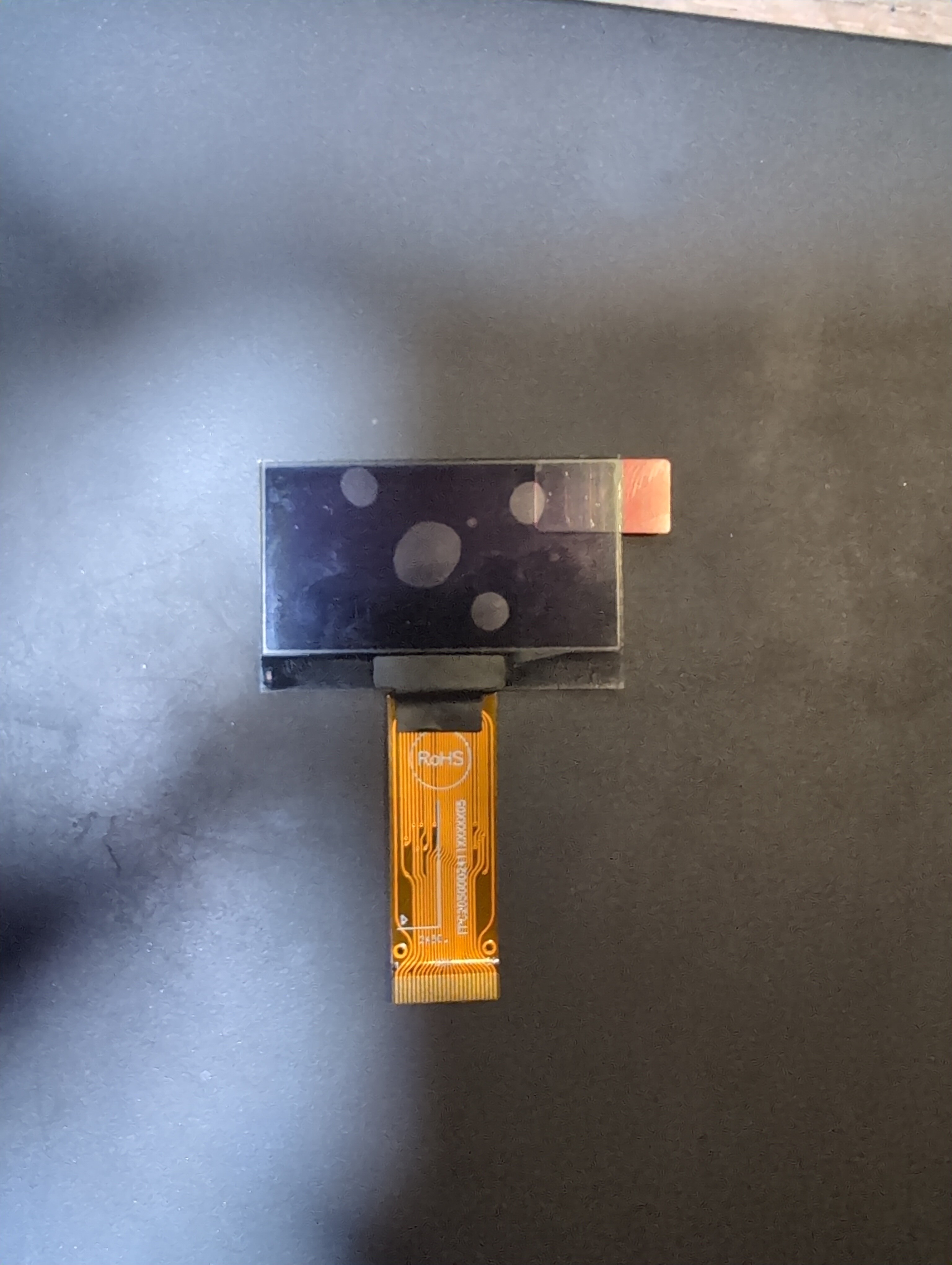

Hey all,
Ive bought this oled, but unfortunately all the guides I've seen online to connect to OLEDS in general presume that the oled has a pinout at the top or sides to connect to. This one does not have that. Any ideas how to hook this oled up?
Link to model and datasheet:
https://www2.mouser.com/ProductDetail/Microtips-Technology/REX012864AYAP3N00000?qs=DuoOggApuK9cgsU8SjE4Dg%3D%3D
REX012864A_DSL
There is a pinout for the connector in the datasheet on the page you linked to.
I also saw that, but physically i cannot see it on the oled itself. Might be that i am blind... Or it is defective?
I attached front and back photos
You've got the pinout in the datasheet; why does it matter that it's not printed on the display?
Edit: you do realize that the FPC cable hanging off the bottom is the connector, right? It plugs into a matching FPC housing?
You are 100% right. Just need to order that fpc housing then. Thank you very much!
