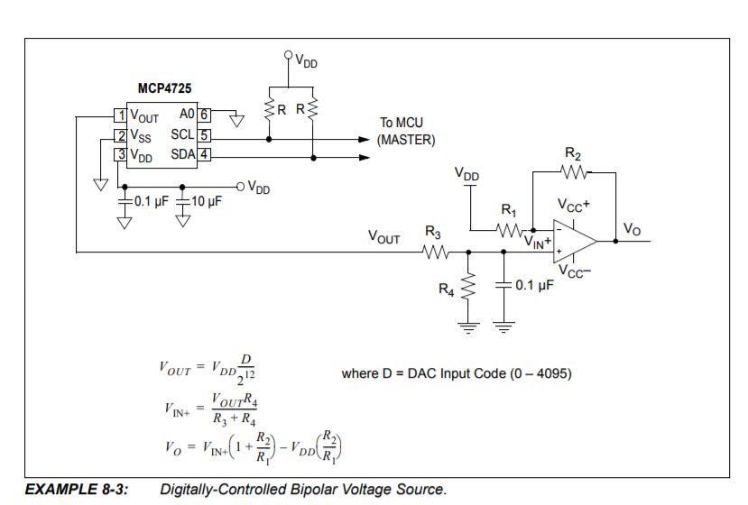

so i want arduino to output 2.5V/-2.5V through DAC. So i have the MCP4725 and it looks like its doing what i want.

The DAC doesn’t output a negative voltage only 0 to supply voltage. Have you got an op amp on the output to make it bipolar?
Suttle0577 See this is where I struggle with it. I have lm315 somewhere. Can I have thought diagram on how this should be connected please? Thanks
Page 31 has a diagram.
All info is in the data sheet for connecting and using the dac.

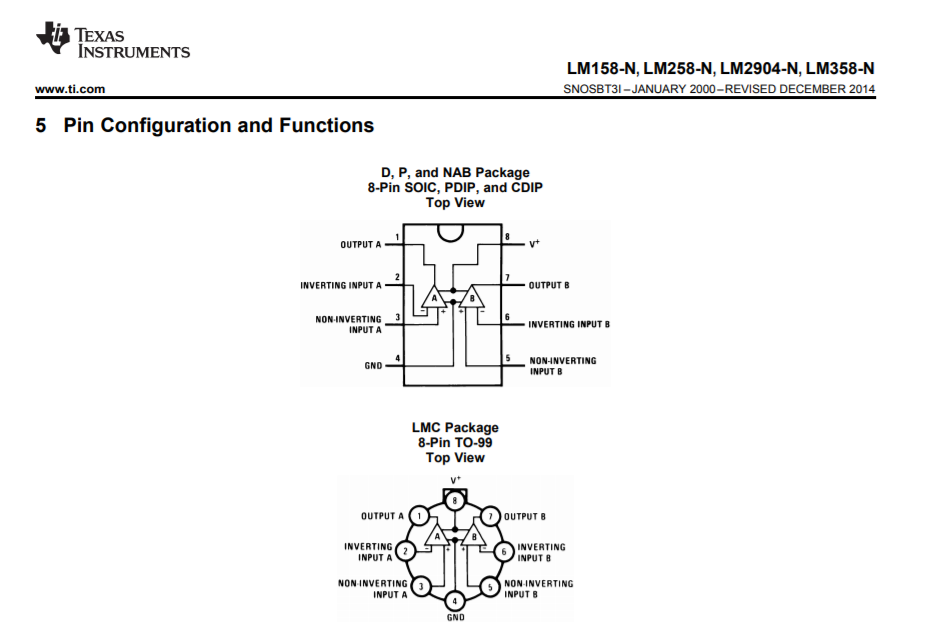

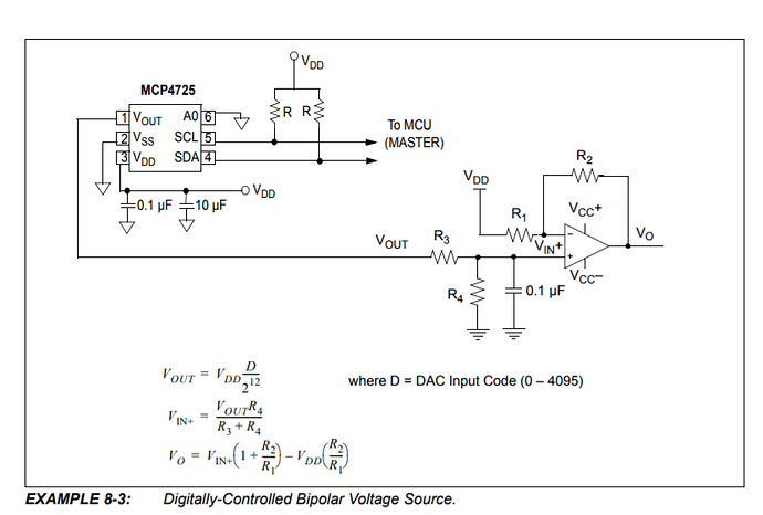

So I wired as per diagrams attached, and i have 2.7v at the start (potentially becaususe i used 22K resistors instead 20K which i didnt had at the time) and its going down to 0.6v on the positive side and stops. Cannot get inverted value at all.
I used LM358N which i had.
Not sure what i`m i doing wrong guys.
Any advice?
do you have a -5v connected to the op amp.
Well no, i don`t have bipolar supply. This the whole story here is to have +5V supply and 2.5v/-2.5v out.
Edit:
I have +10v and -15V available on the machine.
ok, another question.
If i got it right, as I`m completely zero knowledge about op-amps.
if i provide +vcc of 10v and -vcc of -10v to the op-amp and if i drive mcp4725 from Arduino 0-4096, than on the output from op-amp i will have full scale -10v/+10v? if so, this would be great. ![]()
yes you should get +10v to -10v.

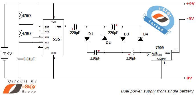

picture of a dual voltage power supply. change the 7909 for a 7905 and use a +5volt supply instead of the 9volt and should work fine.
