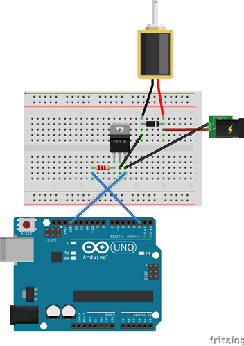

Thanks everyone for the support,
I plan on using the CAT5 cable only to control the valve (blue wires). Each group of valves would be connected to their own 12V power source. (via AC power adapter)
Here is a link to my exact solenoid valve: http://www.sparkfun.com/products/10456
I'm new to everything and you all slightly confused me so I drew up what I have, let me know your suggestions before I fry something on my board.
Blue = CAT5 cable to arduino
Black = GND
Red = Power
NOTE: Solenoid is different in image.
I would connect the valve with power and a relay together into a package that could turn on or off with a switch.
Then I would substitute the switch for something low power to the Arduino like an opto-isolator or shift register.
yep just fine what you made and repeat it.
you can with shielded cable control 8 valves.
with utp only 7
as all gnd can be tied together.

Hi GoForSmoke, cloud you explain a bit more?
I did a bit of googling and your idea may sound more of what I need for my final project beyond the breadboard.
Can you make the valve work without Arduino, control by pressing buttons or switches by hand?
I could however the end scope for my project is for a stage show where I would have things timed together in sequences. eventually wanting to add pressure sensors, water level sensors and LED lights for effects.
When you have the valve working at a button press then you replace the button with something that the Arduino can switch easily and safely at 30 feet. Try to keep the power part separated from the control part.
