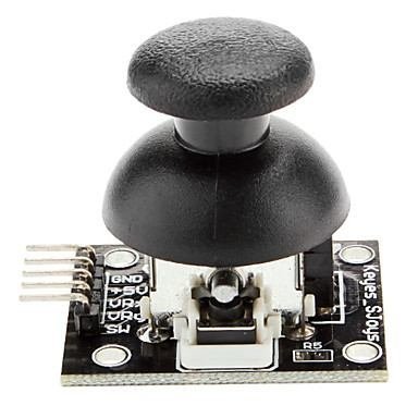

Thank you for your reply!
I have this joystick: http://ecx.images-amazon.com/images/I/41hxVjILi%2BL.jpg
What i want to do is control the ship with the joystick and shoot enemies with a button. I know how to set up the connection between Arduino & processing, so i guess i need help with how to change the processing-code to work with the joystick + button instead of the keyboard. And maybe the techstuff with the joystick and the button (newbie) hehe.

First you have to establish a link between the Arduino and Processing to do this:-
Add this line to the start of the code:-
import processing.serial.*;
String adaptor = "/dev/cu.SLAB_USBtoUART";  // *** change to the name of the device driver to use ***
This is the name of the port you want to connect to, get it from the Arduino IDE when you connect your arduino up to down load code.
Then in the setup function add this line
portConnect();
Finally add this function
void portConnect(){    // Open the port that is the arduino
      // if the device you are looking for is
      // not avaliable the program will
      // connect to the first one in the list
      int portNumber = 99;
      String [] ports;
      // println(Serial.list()); // uncomment for full list of serial devices
      ports = Serial.list();
      for(int j = 0; j< ports.length; j++) {
         if(adaptor.equals(Serial.list()[j])) portNumber = j;
      } // go through all ports
      if(portNumber == 99) portNumber = 0; // if we haven't found our port connect to the first port
      String portName = Serial.list()[portNumber];
      println("Connected to "+portName);
      // port = new Serial(this, portName, 57600);
      port = new Serial(this, portName, 38400);
      port.bufferUntil(10);  // call serialEvent every line feed
Now to listen to what the Arduino sends add this function stub
void serialEvent(Serial port) {  // this gets called every time a line feed is received
  String recieved = port.readString() ;
  // println(recieved + " from serial port");
  // add stuff exactly like your keyPressed() function to do stuff on receipt of characters from the Arduino
Now your Arduino has to talk to processing:-
Set your Arduino to send at 38400 baud.
Get your Arduino to send single characters followed by a line feed by using things like:-
Serial.println("U");
Do this with push buttons at first controlling what is being sent. Only when this is going, extend it to read the joystick.
