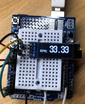

The current project.
I am working on this design for a classic Thorens TD 124 turntable.
My target is to be able to build the hardware so it can be build in the Thorens without any mechanical changes. I expect to replace a 50Hz lamp for the strobe with the ATtiny85 and OLED 128x32 display.
And for the Arduino coding.
I see light ahead.
I have found this OLED library: Tiny4kOLED
And I have the function working with interrupt on pin PB1 on the ATtiny85.
I will of course post the code here when it is ready.
And again - all your help here made it possible for me get this solution working. Thank you
The attachedment: the OLED 128x32 display with a big font. :slight_smile:
I have now the working sketch for Arduino ATtiny85.
If anyone is interested - I will of coarse have an Eagle board for the project.
This is the ATtiny85 code:
/* Project name: Gramophone speed measuring -------------------------------------
 * Version: Project-2019-11-V1.3
 * Parts:
 * ATTiny85 (8 MHz)
 * x-tal 8 MHz
 * OLED (I2C) 128x32
 * IR sensor - Tcrt5000 Sensor
 * Resources: ATtiny85;  7574b / 92% - 137b / 26%
  #include <Tiny4kOLED.h>
  // --- interrupt definitions --------------------------------------------------
  #define INTERRUPT_PIN PCINT1               // This is PB1 per the schematic
  #define intrpPin PB1                       // Interrupt pin: PCINT1/PB1/pin 6
  #define PCINT_VECTOR PCINT0_vect
  //--- variables defined -------------------------------------------------------
  float rpm;
  volatile byte intrpCase = 0;
  unsigned long stopTime = 0;
  volatile unsigned long startTime = 0;     //start platen index pulse time value
  volatile unsigned long endTime   = 0;     //end platen index time value
  //--- average variables -------------------------------------------------------
  int x = 0;boolean avgCalc = false;
  float rpmAvg, avg[10];
void setup(){
  // --- Display setup ----------------------------------------------------------
  oled.begin();
  oled.clear();oled.on();
  oled.switchRenderFrame();
  // --- Sensor setup -----------------------------------------------------------
  cli();                            // Disable interrupts during setup
  PCMSK |= (1 << INTERRUPT_PIN);    // Enable (ISR) for pin (PCINT1/PB1/pin 6)
  GIMSK |= (1 << PCIE);             // Enable PCINT interrupt
  pinMode(intrpPin, INPUT_PULLUP);
  sei();                            //Enable interrupts after setup
  // --- Display start text -----------------------------------------------------
  vis();
void loop(){
  rpmCalc();
  disp_msg();
  // --- update delay -------------------
  unsigned long waitMillis= millis();
  while(millis() - waitMillis < 1000);
//*************************** rpm calculation  **********************************
void rpmCalc(){
  float calcTime = 0;signalCheck();
  calcTime = (endTime - startTime) / 1000000.0;
  rpm = (1.0 / calcTime) * 60.0;
  // --- calculate average value -----------------------
  avg[x] = rpm;
  if(x < 10){x++;}
  else{x = 0;avgCalc = true;}
  if(avgCalc == true){
  for(int i = 0;i < 10;i++){rpmAvg += avg[i];}
  rpm = rpmAvg / 10;rpmAvg = 0;
ISR(PCINT_VECTOR){
  switch(intrpCase){
    case 0:break;
    case 1:startTime = micros();break;
    case 2:endTime = micros();
  if(intrpCase == 1){startTime = micros();}
  if(intrpCase == 2){endTime = micros();}
  intrpCase = intrpCase + 1 ;
//*********************************display rpm function *************************
void disp_msg(){
   oled.clear();oled.setFont(FONT16X32);oled.setCursor(30,2);
   oled.print(rpm,2);oled.switchFrame();
void signalCheck(){
  intrpCase = 0;stopTime = millis();
  do{if(millis() - stopTime > 5000){pwrOFF();}
  }while(intrpCase <= 2);
//*****************************no switch Power OFFF message *********************
void pwrOFF(){
  oled.setFont(FONT8X16);oled.clear();
  do{oled.setCursor(30,2);oled.print("POWER OFF");oled.switchFrame();
  unsigned long waitMillis= millis(); while(millis() - waitMillis < 500);
  }while(digitalRead(intrpPin) != 1);
void vis(){
  oled.clear();oled.setFont(FONT8X16);oled.setCursor(0, 0);
  oled.print(F("Thorens TD124-II"));oled.switchFrame();
  while(millis() - waitMillis < 3000);
//*************************** E N D  ********************************************
