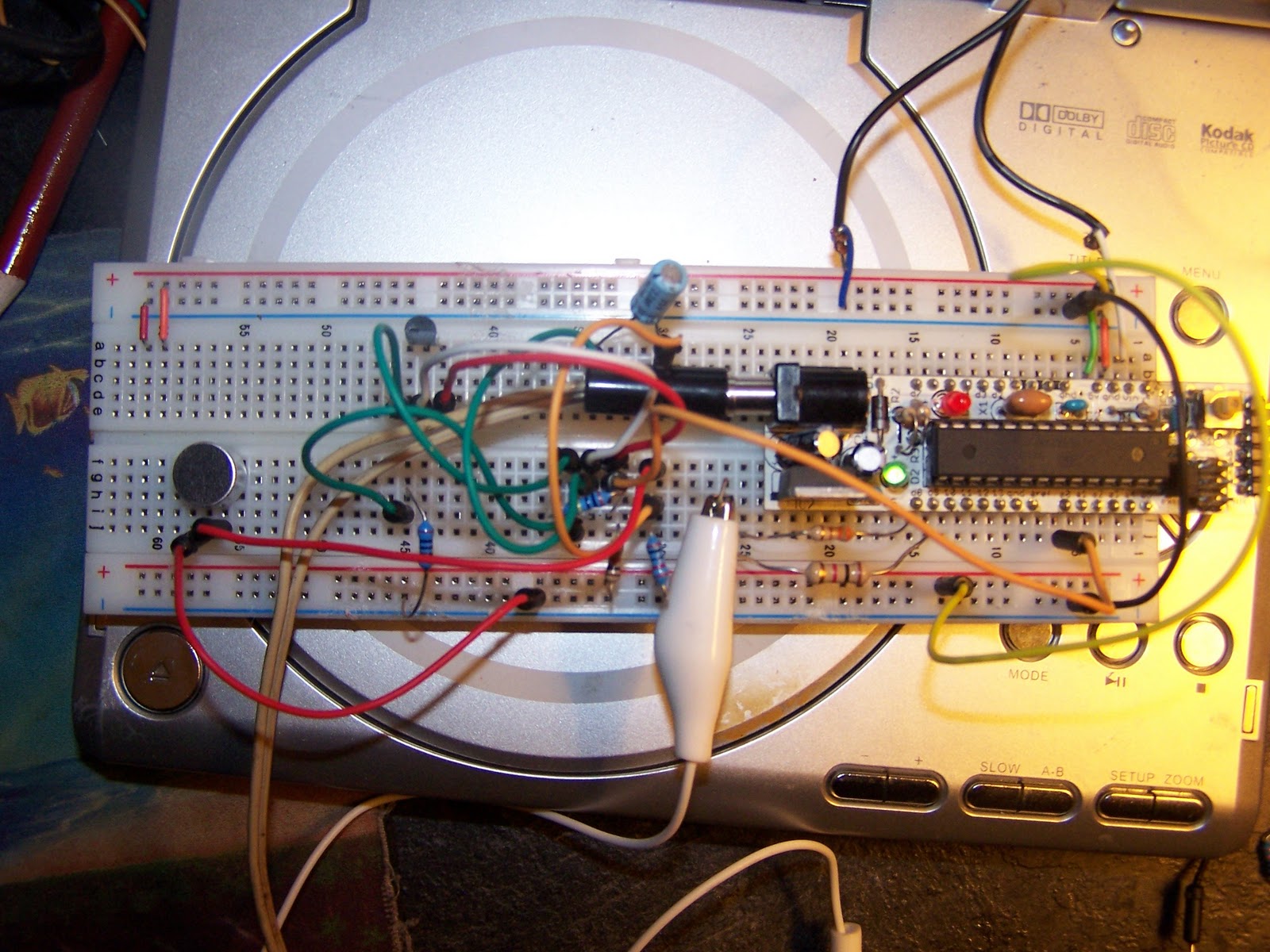

You could use a chip like this
to break the music into bands, then reading the outputs will allow you to sync with the music.
What about using FFT to detect music frequencies?
