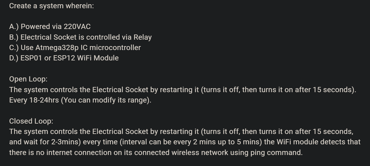

I can't speak about the actual project as the descriptions you have provided (and been provided) seem to be so incomplete that it is simply not possible to create a project.
i.e.
I'm doing a project on programming ESP-01s with Arduino Uno required by my teacher.
And the
"Create a system wherein" image of A) to D) list of "requirements"
Are simply missing too much information to be able to even write up a high level description of the project much less be able to define the h/w and user interfaces needed to be able to start coming up with the design, all of which must be done before any code is written.
i.e. I'm a FIRM believer that things should be defined and then designed before any code is written.
My first questions would be why are multiple processors mentioned? i.e. why even use the UNO?, but then this goes back to having such incomplete requirements.

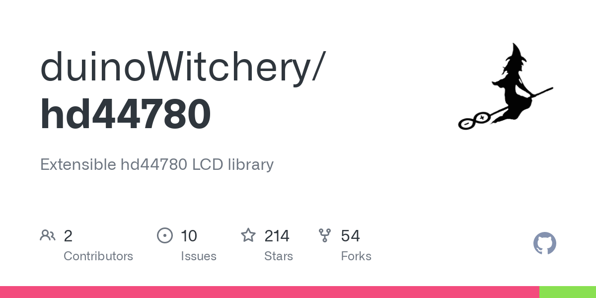

In terms of getting the ESP talking to the LCD, I would recommend using the hd44780 library. For a PCF8574 based backpack you will use the hd44780_I2Cexp i/o class. It can auto configure itself.
It includes a diagnostic sketch, I2CexpDiag, that can test the h/w and report any issues that it can detect.
After you install the hd44780 library, the first thing you should do is to run the included diagnostic sketch. The library includes many examples for each i/o class.
Look at the ones for the hd44780_I2Cexp i/o class.
The hd44780 library is available in the IDE library manager so you can install it directly from the library GUI with no messing with downloads or zip files.
Here is link to the hd44780 wiki and the hd44780_I2Cexp wiki:
