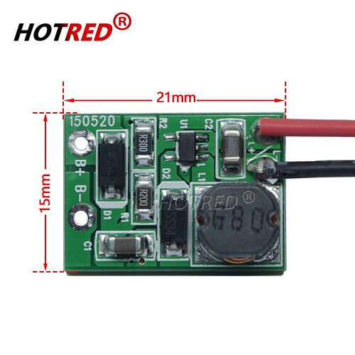

how to drive this 10w cobb, using this led driver

This 10 watt driver works like this
The two R200 and R300 resistors are for the LED current.
R200 is for 500mA, and R300 for 333mA. Both give 500+333= 833mA LED current.
