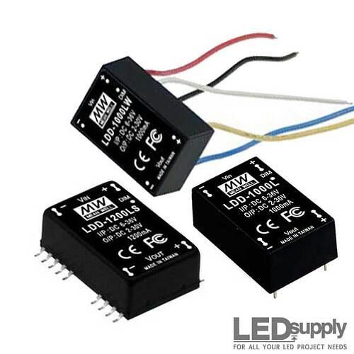

There are some really powerful IR LEDs available.
I use Aliexpress for my supplier. Takes a while to get them.
Requires a constant current driver.
Do a Google search for "led high power ir".
Edit: Here is a link to the ones I use
https://www.aliexpress.us/item/2255800880304876.html?spm=a2g0o.order_list.order_list_main.20.38631802SpRZxI&gatewayAdapt=glo2usa
I get my drivers here
The drivers have a digital control line that allows PWM

Could you explain how to use and to link drivers (i didn't know this component)
