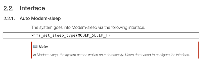

One possibility is to use what I have found in a document from Espressif called "Modem sleep".
With that I may get down to some battery drain that is OK....
Does not say how low it gets, though.
So how exactly do I enable this mode such that I can have my loop running checking the input from the switch (using GPIO2) and when detected enable WiFi and transfer the data via MQTT and then set it back to the "modem sleep mode"?

Yes, and it says the following:
So, in Arduino/PlatformIO how do you execute that call?
Is that implemented in some helper function?

Check This (first hit on Google)

So from the link i posted earlier.
Auto Light Sleep
Behavior:
After an idle timeout of 10 seconds the WiFi hardware will be shut down. It wakes up every <100 ms * Access Point DTIM interval> to check for incoming data. Furthermore while the program is running delay() the system clock will be shut down too.
Note: If the WiFi connection is not configured or not reachable, the chip will not sleep at all.
Note: Auto Light Sleep will not happen if there are no delay() or only delay(0) calls in the code.
Consumption:
If Wifi is idle, about 70 mA until timeout, then about 2 mA.
When to use:
Recommended power state if you need Wifi connectivity.
Because of the halted system clock some peripherals might not work in this mode, use Auto Modem Sleep in those cases.
extern "C" {
  #include "user_interface.h"
  wifi_set_sleep_type(LIGHT_SLEEP_T);
And if i understand correctly the ESP will sleep for the period of time that you call delay() and run using about 2mA, that would be great, still more than with an ATtiny controlling it but really not bad.

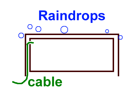

How about laying a flat cable through a window to go from inside to outside
and then go into a small box where you go in with the cable in a rain-protected way?
