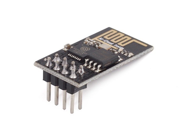

I have this kind of ESP8266 module:

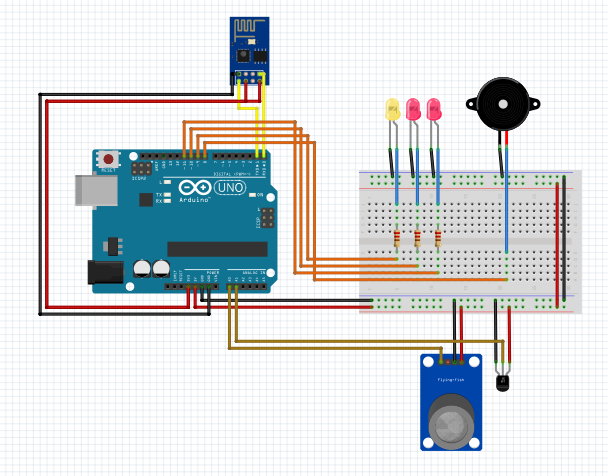

Here's my circuit:
Circuit
What should I do to externally power them? Or maybe did I do something wrong with my circuit (since I don't really know how to interface the ESP module with Arduino Uno)? I am looking further to your responses.
Clearly not. :worried:
You need a diode and a pullup resistor to interface the TxD of the UNO to the Rx of the ESP-01 as it is a 3.3 V logic device. Similarly. I don't think connecting RxD of the UNO to Tx of the ESP is actually a good idea.
I believe the genuine 3.3 V regulator on a real UNO can actually supply sufficient current to operate the ESP-01, so that will probably work, though a 470 µF capacitor across the 3.3 V might be a good idea.
Best way to power it is with a USB "phone charger".
And I don't like the idea of using a UNO. A WeMOS D1 Mini and a DS18B20 instead of the LM35 would be far easier.
I won’t do that at all. From the TX of the uno you need to cut down the 5V to 3v3 so that will be a potential divider with a 510R and a 1K resistor. On the TX of the ESP-01 you need to boost the signal from 3V3 to 5V. This is best done by using two of the inverting buffers in a 75HCT14. You might see others say this is not needed but without it is not sure to work.
Well it is a physical layout diagram and quite poor at that. Nothing I has labels.
It all depends on how you want to play it. You seem to be quite short on input / outputs on that ESP so you will need some sort of port expansion, possibly at 5V. It is altogether a different project.
If you stick with the configuration you have then you will need some sort of switching to ensure you can program each processor. Something that you can’t do with the circuit as it stands. Quite honestly I wouldn’t start from here.
I would advise you use one ESP board but one with a lot more free pins than you have here.
No, a diode (cathode to the Arduino) and a 1k pull-up to 3.3 V.

Note: Using Fritzing will reduce the pool of folks prepared to even look at your problem. Please draw a schematic.
