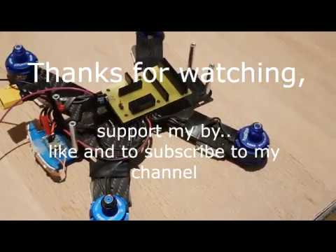

Old thread??? this is exactly what I was looking for!! many thanks... I'm making my own 5inch multiwii racing drone project atm, and have designed my own PCB....
and had 2 compasses with the IC "DA 5883 6010" that I did not work.
and guess what!! your addon in the sketch workss. only he is quite sensitive, the numbers jumping around
do i still have to adjust that?.
good job :wink:
