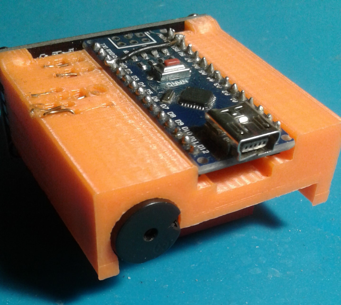

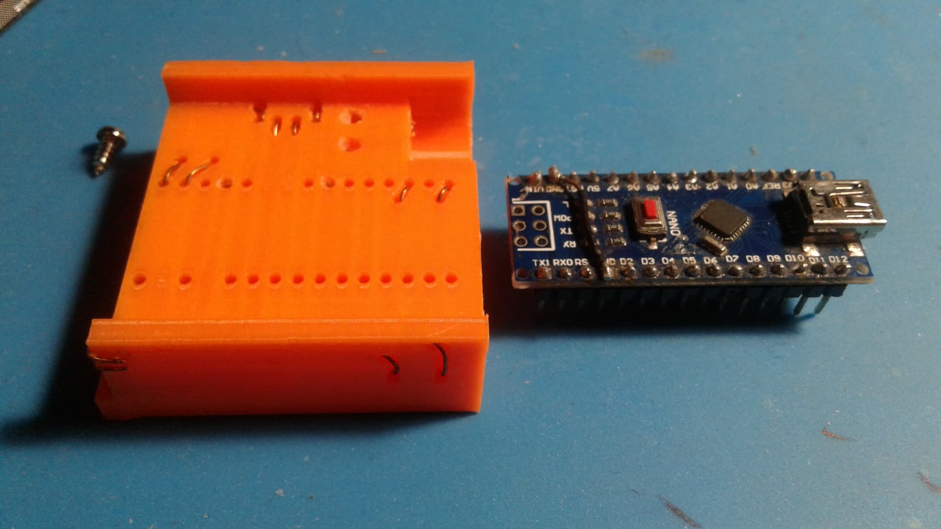

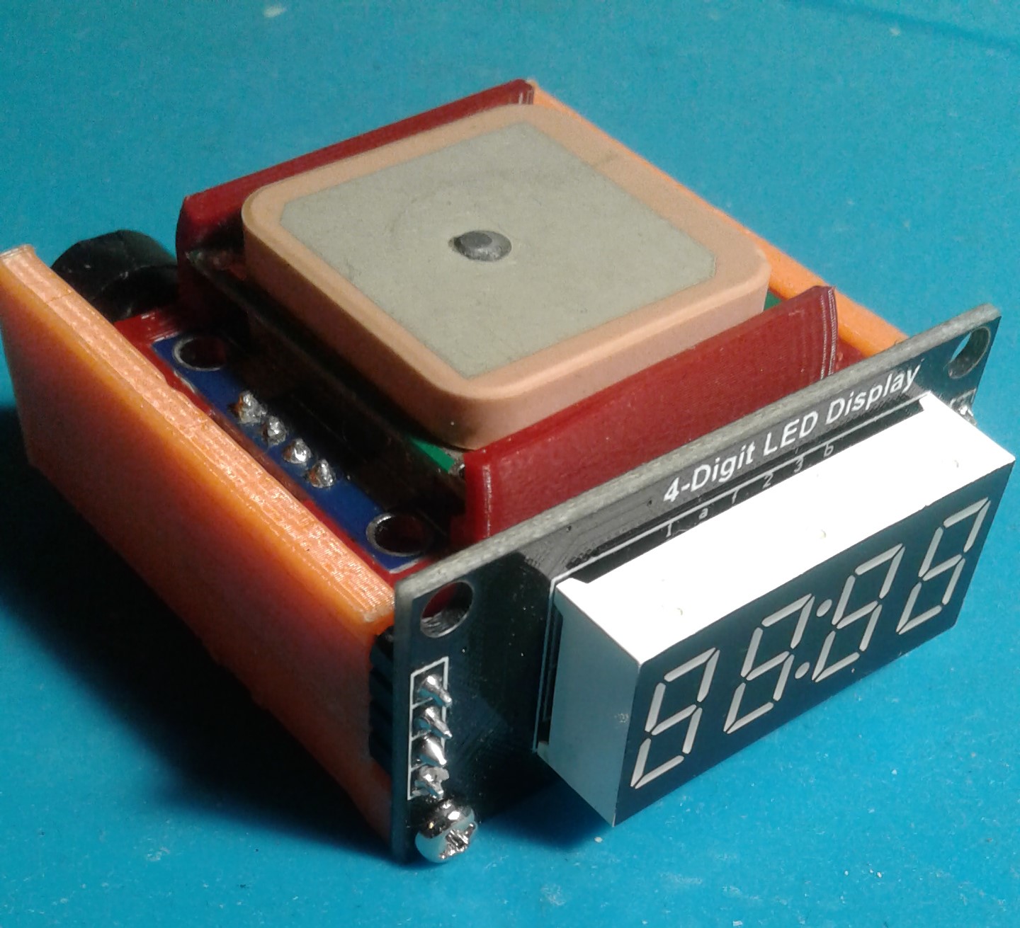

I've been making 3D printed "blocks" with holes and conduits for the microprocessor and sensors. It's kind of like a 3-d PCB. Allows for rapid assembly (and reliable connections) and very compact.

Curious about those eight variously located wires/connectors?

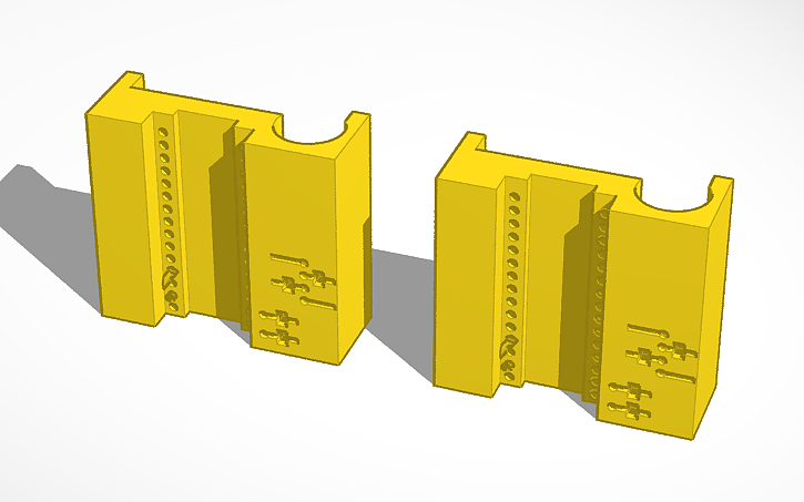

I've made the design public in Tinkercad:

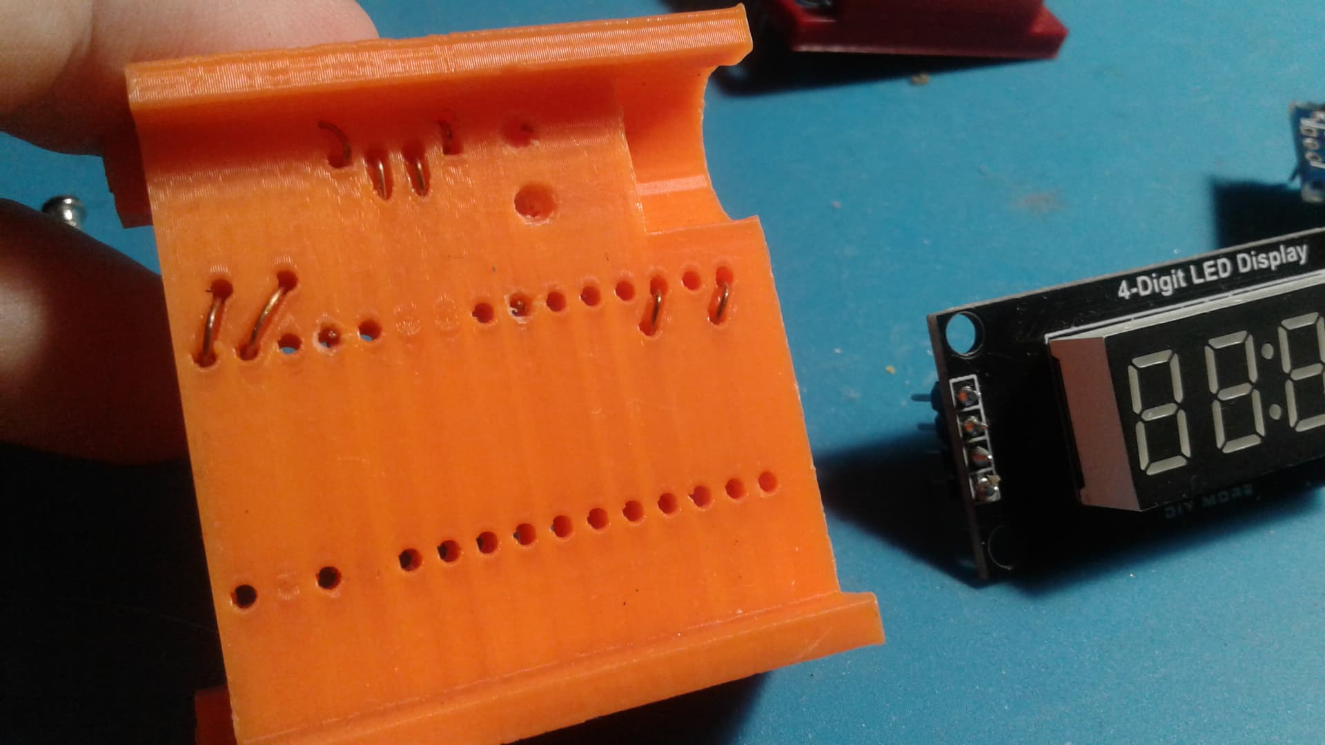

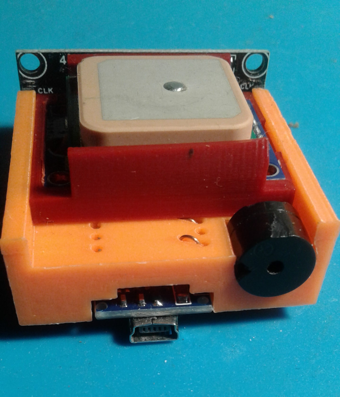

I call this method monobloc. It's difficult to explain the concept in words. Imagine the bloc is solid. Then include holes to take the pins of the components. In the 5th pic you can see two rows of holes to take the Nano. So each component can be inserted into the bloc (pics 1 to 3). Now, to make electrical connections between pins of different components, I design into the bloc 1.5mm conduits running from pin to pin as required by the circuit diagram. I thread each conduit with solid copper wire (stripped), turn over each end and set it into the bloc by the heat of a soldering iron.
Now when the components are inserted some pins are pressed tightly against a wire. The components are physically secure and the connections are electrically robust. The components are removable, making development of the bloc easy.
