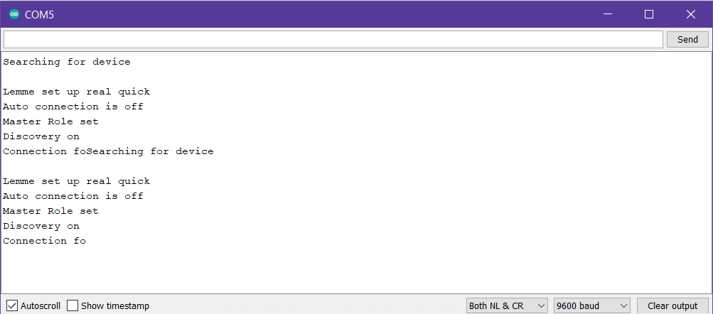

I am currently trying to get my arduino-uno to automatically send AT codes to my HM-19 (very similar to HM-10). The thing is with my code it does not show me if my AT Codes are sending. All I am getting is the Serial print. Here is my code.

I am still pretty confused. I am on the internet searching for all different ways to do this but still cannot arrive at an answer.

Why not write a simple function that accepts a string, and echoes the string to both Serial and BT?

void echoAT (const char* ATstring)
  blueToothSerial.write(ATstring);
  Serial.write (ATstring);
echoAT ("AT+IMME1\r\n");
(Uncompiled, untested)
problem with if() statement - the ; will terminate the if() - remove it
 if (strcmp(reply,"OK+DIS0:E4E112960A56:-050:CarAlarmS")==0);
when you transmit an AT command you should wait for a response and check it it is correct, e.g. a function like
// send a single command to the modem, wait for a response or timeout or ERROR
// return 1 for OK, -1 for timeout, -2 for ERROR
int Command(const char *command, const char *response, int timeout)
That string is longer than 30 character so if your did read the reply and it was equal it means you wrote off the end of your array.
And that ';' at the end of the 'if' statement is the entire contents of the 'if'. Remove it if you want the 'if' to control the next block of statements.
For a test, it might be appropriate to use ".readString()"
#include <SoftwareSerial.h>
SoftwareSerial blueToothSerial(10, 11); // RX, TX
String Reply;
  delay(200);
  pinMode(7, OUTPUT);
  Serial.println("Searching for device");
  blueToothSerial.begin(9600);
  Serial.println("Lemme set up real quick");
  //this step tells me when the device is attempting to connect;
  blueToothSerial.write("AT+IMME1\r\n");
  Reply = blueToothSerial.readString();
  Serial.print(Reply);
  Serial.println("Auto connection is off");
  //allows me to know if the command AT+IMME is sent;
  blueToothSerial.write("AT+ROLE1\r\n");
  Serial.println("Master Role set");
  //allows me to know if the command AT+ROLE1 is sent, configues device to be master upon startup;
  blueToothSerial.write("AT+DISC?");
  Serial.println("Discovery on");
  //lets me know if the device is starting discovery
  if (Reply.startsWith("OK+DIS0:E4E112960A56:-050:CarAlarmS"))
    Serial.println("Connection found");
    blueToothSerial.write("AT+CONN0");
  Serial.println("I think everything is done don't quote me on it though");
void loop()   // run over and over
  if (blueToothSerial.available())
  if (Reply.startsWith("OK+CONN"))
    Serial.println("1");
    digitalWrite(7, HIGH);
    blueToothSerial.print("0");
    Serial.println("0");
    digitalWrite(7, LOW);
