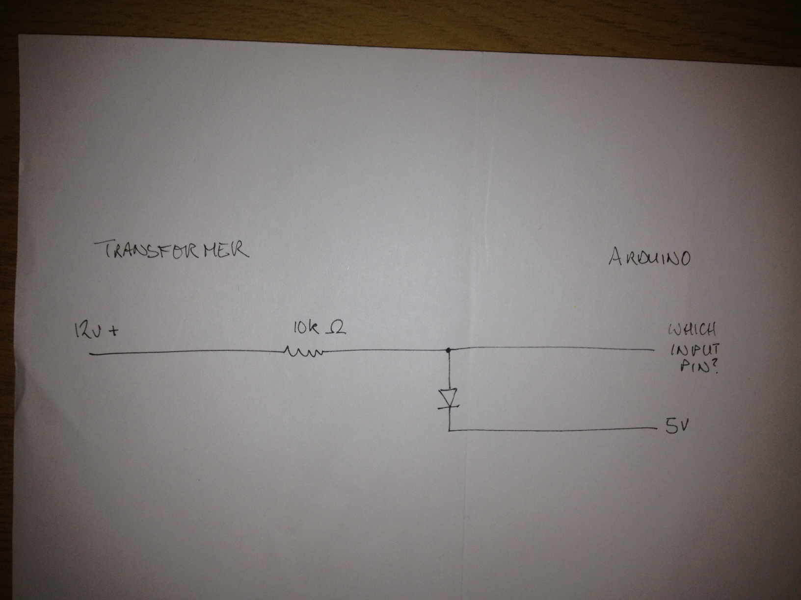

I take the 12v +ve output from my transformer (it's a Dialight MDU-18) and feed it in to a 10k resistor. That resistor is then used as an input to my Arduino. Which input pin should I use? Sorry, I think I should be using a digital pin but I'm not sure. I've drawn this circuit and attached an image of the diagram.

DVDdoug:
Put a resistor (~10k would be good) between the 12V from the transformer and one of the Arduino's inputs. Then connect a diode between the same input and the Arduino's regulated 5V power supply (i.e. the "5V" pin), with the anode on the input (i.e. "point" the diode toward the 5V supply). Any regular silicon diode will work, since there is very little current through the 10k resistor.
Whenever the voltage goes above 5V (plus the ~1/2V drop across the diode), the diode "turns on" and "clamps" the voltage at 5V (plus the diode drop). The "remaining" ~7V gets dropped across the resistor.
What definitely is missing is the connection from the 0V pin of your 12V source to Arduino GND.
Not sure if it's a good idea to sink those probably noisy 12V into the 5V ? But if your Arduino is not doing anything else, why not...
A 4.8V zener diode to GND, or a 4.7k resistor to make a voltage divider 2-1 = around 4V at the digital pin, might be more suitable.
Any digital input (except 0 and 1 for Serial) should be fine.

Thanks michael_x! That worked a treat. I used the version with the diode and it's perfect!
