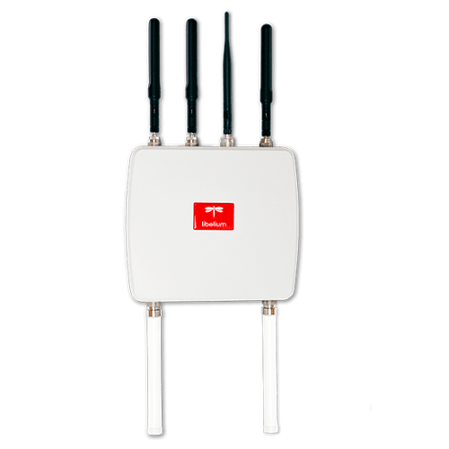

Yes, I understand, but in this case, how is this company collecting this information?
Ask the company.
(detect device) != (collect and store personal information)
They probably struggle nowadays with the WiFi privacy techniques that were developed to fight this tracking
