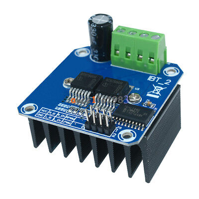

if you need more amperage you could use this one
BTS 7960 chip
> **[Double BTS7960B DC 43A Stepper Motor Driver H-Bridge PWM For Arduino Smart Car...](https://www.ebay.com/itm/334899613479)**
> Able to reverse the motor forward, two PWM input frequency up to 25kHZ;. Double BTS7960 large current (43 A) H bridge driver;. Just need four lines from MCU to driver module (GND. two heat flow passing through an error signal output;. ).
best regards Stefan

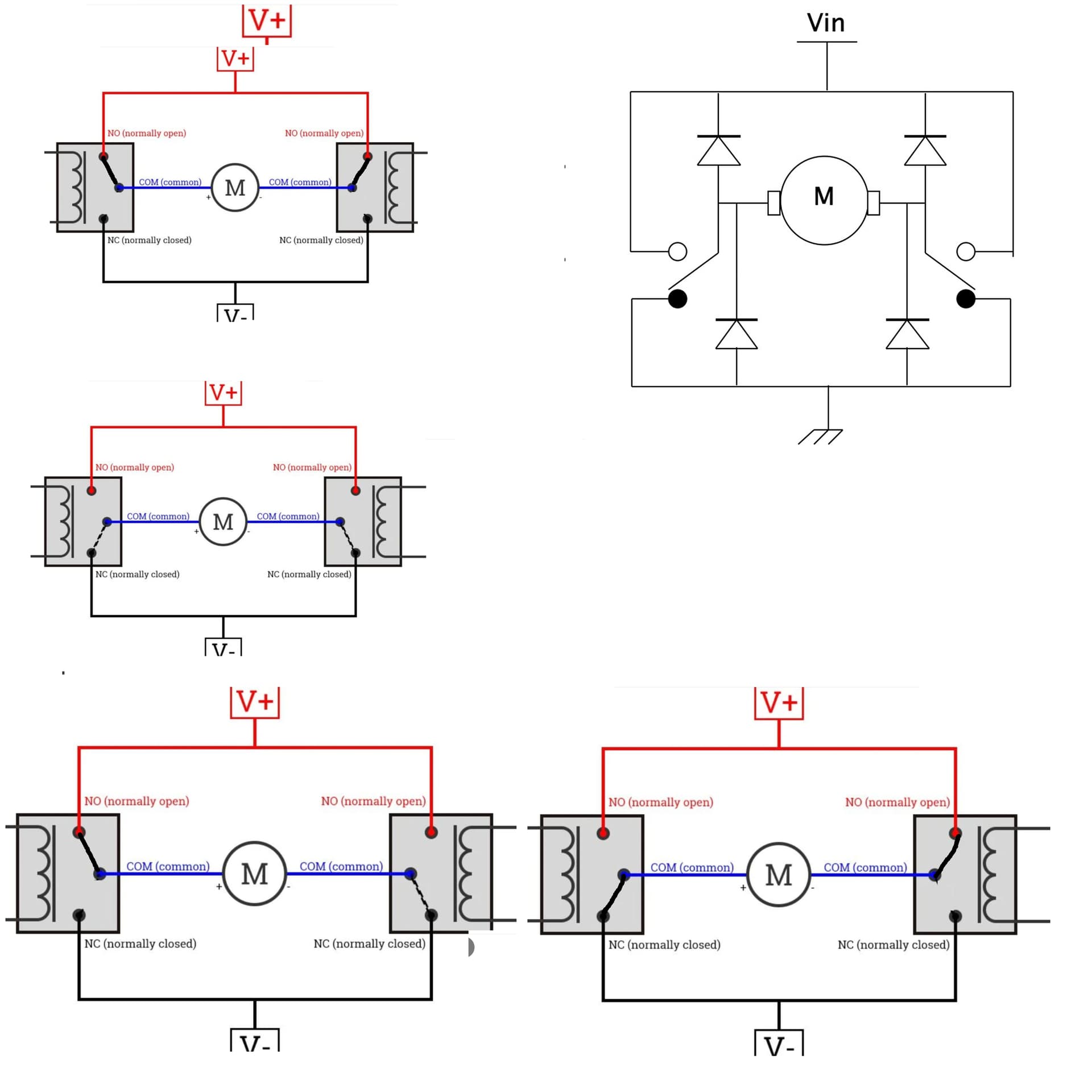

> [@robotbramhana](#):
> Since my motor has to rotate in both directions, can I choose any of the terminals as cathode and anode for adding a flyback diode?
No you can't. You have to use four diodes like in this diagram.

Hi @Grumpy_Mike
maybe I have a knowledge-gap that I'm not aware of and if this is the case
I would like to close this knowledge-gap.
As far as I understand it you would not need any diodes in a **relay** -H-bridge
Here are the four possabilities how the relay-contacts could be switched
 ![image](https://europe1.discourse-cdn.com/arduino/original/4X/b/2/3/b23b5f80e0ea70f16cea739609ff219611215592.jpeg)
Either there is connected GND to GND
or
plus to plus which is no problem
or the motor is inbetween Plus and GND but that is how you connect the motor anyway.
So what makes it nescessary to add the diodes?
Is this because if you change polarity while the motor is at maximum rpm the motor acts as a generator and would feed in a voltage that could destroy anything?
I appreciate it very much if you would explain the details.

> [@StefanL38](#):
The diodes are needed to prevent the back EMF from the running motor. If you look at the data sheet of a ancient chip like the L293 you will see that these diodes are incorporated into the chip internally.
 ![Diodes](https://europe1.discourse-cdn.com/arduino/original/4X/5/5/6/556f365d63bb93803468a768c5df3827897d02ed.png)
But note this is only for one of the three motor drivers. If you want to make the other pair of motor drivers into a H-Bridge to need to add these external diodes.
If you are using relays to implement a H-Bridge then you need these diodes, for exactly the same reason, that is the interference caused by the motors. The fact that one end is connected to ground doesn't matter without a flyback diode you will still get interference generated.
> [@StefanL38](#):
No, what happens there is that the motor becomes a generator of opposite polarity and discharges the energy into the the motor itself to stop it turning. This is called regenerative breaking and the motors stop quicker. In fact in Switzerland the electric (battery run) busses use this regenerative breaking current to actually charge up the batteries. A dam clever idea.
Hope that helps.
