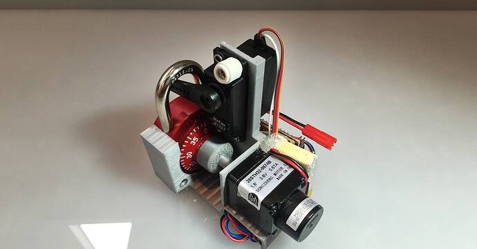

Does anyone have a solution on how to turn a knob? I have a stepper that I can control just fine, but I want it turn a knob (1cm diameter). Right now I am using tape, but was hoping for a more mechanical device, I have not found any solutions.

It is a standard Master Lock combination lock like you use in the gym. I call it a knob because I am looking for a generalized solution. One idea I had was to use a 2-part shaft collar with one part glued to a shaft flange and connect the shaft to the stepper with a shaft coupler. But this requires a new collar-flange assembly for each different diameter knob.

Many people use a 3D-printed cup, like this:
If you want something more universal, take the sticky stuff from a "dashboard sticky pad" and mount that on a disk on the end of your motor shaft. When pressed against the center of a combination dial it will probably provide enough torque.
Find any cnc or laith machines workshop and design it on your own. Make a hole in the piece in which you will insert the shaft of your motor and then a screw to tighten it.
I guess I'm just surprised there is no 'off the shelf' solution, no wonder I couldn't find one. Of note, for smaller knobs, you can get a replacement 3/8" drill chuck for $10 that would work.

Depends a lot on the type of tools you have available to you, and the accuracy of rotation you need to achieve, How about a cupped or two or three arm, forked adapter, larger than the largest knob to be turned, each arm fitted with a set screw?

thingiverse.com has 3D models for assorted scroll chucks that could be 3D printed and clamped on to a wide variety of knob sizes.

Which is kind of what I was searching for, but I do not find any matches. Searching "three arm forked adapter" doesn't result in any hits. But it is the design I had in mind. So it looks like 3D printed specialized parts are my best option.

One more idea: Check out a Longworth chuck. The concept is exactly what you need. Unfortunately, the commercial sizes all seem to be way too larger for want you want. There are many tutorials on making your own, but again, may require more tools than you may have available to you.
There are also 3D printer models for Longworth chucks that might be adaptable to your needs. You would still likely need to buy the pins. Sometimes local libraries have 3D printers you can use for a nominal fee. Of course, this is all getting further from a "simple" adapter.
