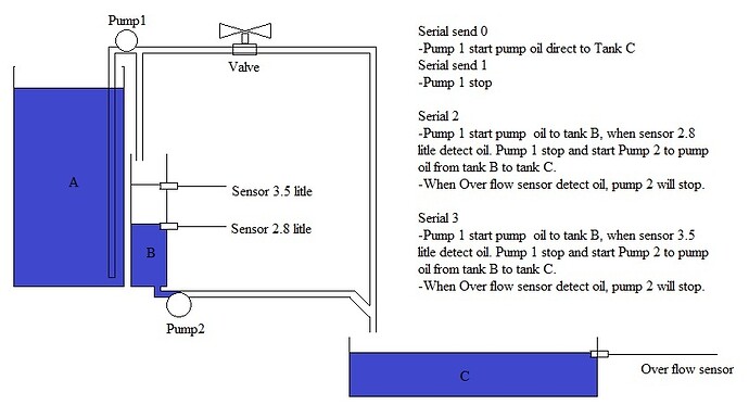

Yup, i want to used output pin read for avoid from sensor 2.8 liter run their code before 3.5 liter sensor detected.
Here i attached a picture to help other understand better.
Let say the code is working, if i send serial data 2, pump1 start pumping oil from tank a to tank b, senosr 2.8 liter detected then pump 1 stop and pump2 start pumping oil from tank b to tank c. After over flow detected pump 2 stop.
But if i send serial data 3, it will be stuck on 2.8 liter sensor not 3.5 liter sensor.. ;(
If there any better suggestion please guide me..

Input sequence i mean, if i choose to sensor 3.5 liter detected oil, then all program for sensor 2.8 liter will not run..
Here my schematic diagram
Hey guys, it work ;) my bad soldering, i dont know why it act like that, but i mistaken join Pin11----Led----bypass the resistor-----GND.. Then the code not detected it as HIGH. After i remove the bad soldering and Pin11----LED---220 ohm ------ Gnd. Then it work perfectly. Thank guys for your time.
