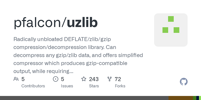

How to include uzlib? It's on Github, but...
I would like to uncompress some zlib compressed data, and it appears uzlib on github will work. However, it is a bunch of C files (not cpp) that compile down to a .a library file (unix style lib, I'm on OSX).
