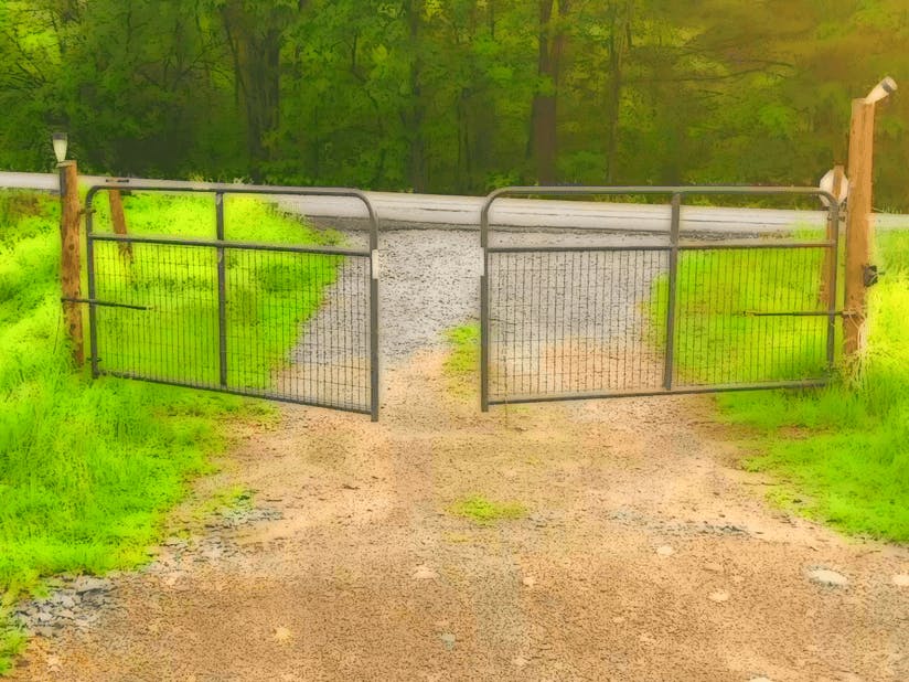

I am now updating the linear actuators because, well, the last ones are GARBAGE and have both broken several times. So I bought these (data sheet) and am now getting around to hooking them up.
They have a builtin hall effect sensor so I can tell how far open or closed the gates are, and when to stop them / turn them on. I am having some issues with programming and hooking them up.
  • The hall sensor is powered by 5V, so I assume the hall outputs are 5V? Could I power it off of 3.3V? I didn't see that in the data sheet. I am controlling them with a Wemos D1-Mini, hence the 3.3V question for the hall sensor.
  • If the hall sensor only outputs 5V, how could I drop it to 3.3V for the wemos input?
  • How would I code for it in the first place? The hall sensor outputs 11,278 pulses per inch. The actuator moves at 0.51 inches per sec, so in 2 seconds, there would be 11,278 pulses.
Thanks in advance!

I see a potential problem here. Can't they open all the way either? I mean until the limit switches are activated (I hope they have those in addition to the hall sensors)? Because when the Arduino is powered up (or reset) it won't know what position the gates are in. It will need to "home" to the fully open or closed position in order to know what position the gate is in.
Perhaps if the gates cannot open or close far enough to activate the limit switches in the motors, you will need to add a sensor to allow the gates to "home" to a known position.
I designed a new PCB a while back before I got these actuators. Now I'm going to modify it to work with these actuators, and then order it.
Very true. Actually, they can open all the way, but they just can't close all the way. So my idea, is when the gates are turned on, wait a couple minutes while they open all the way (there are builtin limit switches), and then are closed to the correct position.
No need to wait that long. The Arduino will be able to know very quickly when the limit switch is activated because the signals from the hall sensors will stop changing. If you are using a library for a rotary encoder, you can have your sketch monitor the encoder position value and if that does not change for one or two seconds, assume the gates are fully open, then reset the encoder position to zero ready for closing.
Rather than monitor the current through the motors to detect objects blocking the gate, you can use the hall sensors for this also: the rate of change of the encoder position will slow down or stop.
