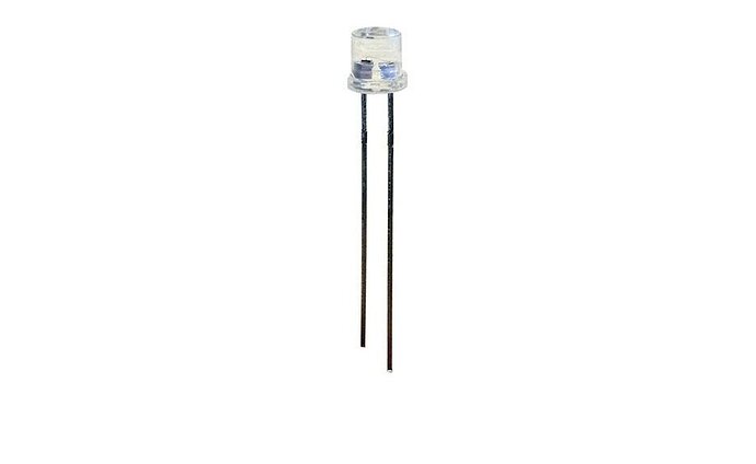

Lastly, you'll want to hook up a third optical interruptor across the path of the door, so you can monitor if kitty is coming thru, and stop the motor activity if it is moving the door downward (maybe reverse it to move it back up). This can be done via an IR LED hooked up to yet another pin on the Arduino, like this one:
http://www.allelectronics.com/make-a-store/item/ILED-8/T-1-3/4-INFRARED-LED-EMITTER/-/1.html
...and a photo-transistor, like this one:
...placed directly opposite of the LED. Wire a regular LED in parallel with the IR LED (or use a cheap web-cam with no IR filter) to be able to monitor the activity of the IR LED. Put a small piece of dark tubing around both the LED and the photo-transistor, to keep stray light from causing issues. Place these about halfway up the opening in the door way, in such a manner that the door itself doesn't block the light path (you may need to position the LED and photo-transistor on the opposite side of the door).
