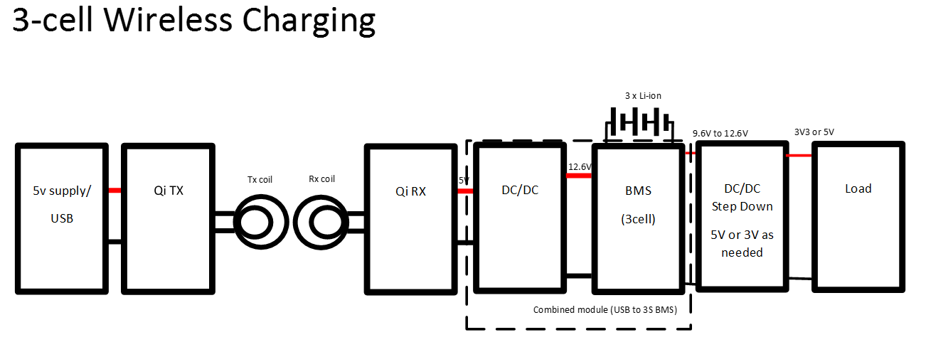

I am working on providing power to some portable underwater equipment, so far I have a block diagram:
I have loads of other things to do, so it will be a while before I get around to producing hardware.

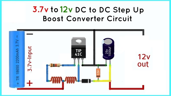

I didn't build this circuit but it seems to meet your need.
But you can search the WEB with the argument:
"Step Up 3.7V 12V"
