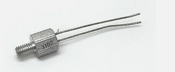

This 5W 1k thermistor from eBay so maybe it is as simple as a thermistor.

After doing some more searching I've come to the conclusion that a high power low resistance thermistor is not a unicorn after all and that must be the device that Triumph, Norton, etc. used.

And doesn't necessarily have to dissipate a lot of power depending on the gauge it's driving. As I learn more about NTC thermistors in that range it looks like power dissipation is not the problem I thought it was.
The gauge is basically an ammeter with a 100 ohm shunt. A couple of hundred mA is nothing.
Understood. The 100 ohm "resistor" in the sending unit that has to dissipate ~1.5 W in a high ambient temperature is the part that I didn't realize was so common. These days, 10k thermistors are more the norm so I don't immediately think of high power.
The gauge is 100 ohms, the sensor is 100 ohms, they are in series with 12V across them thats not 1.5W.
