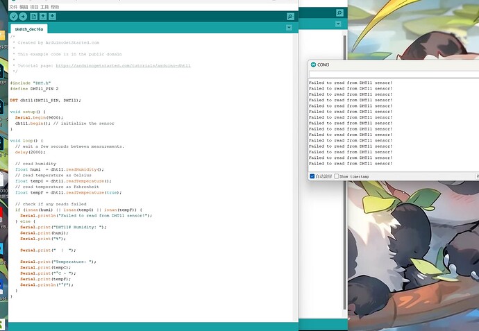

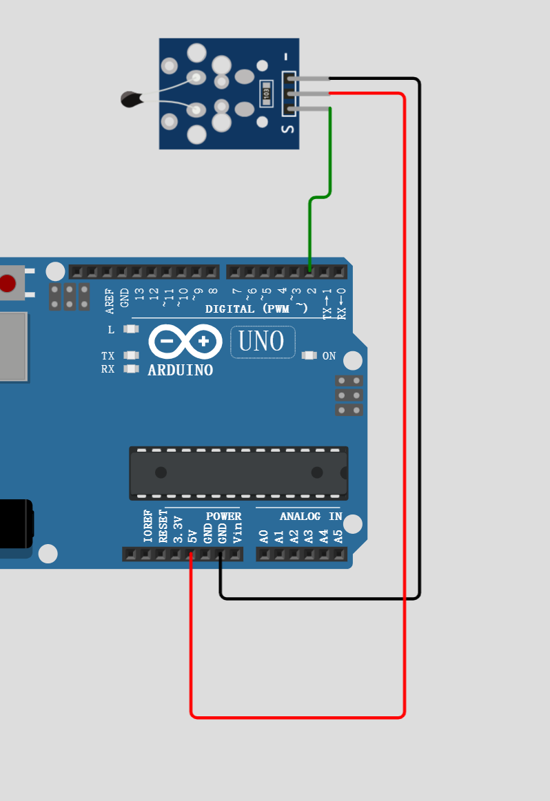

How to make dht11 temperature display temperature correctlyy
I'm a novice and want help
Beacase there is no dht11,ntc is used instead ,what is my problem?

Use code tags (the < CODE/ > icon above the compose window) to make it easier to read and copy for examination
  1. Check the wiring.
  2. Carry out a cross-check with a second sensor.
You cannot use an NTC to simulate an DHT11. You either change your program to read an NTC or obtain a DHT11.

thank you,according to your answer ,I have solved my problem.
