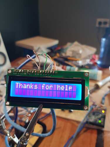

Sorry my images didn't work, I didn't know photobucket had gotten annoying like that:
Jumble of mess, it does make sense:
I had a play with the code, added the state change stuff.
I've gotten the LCD/ultrasonic sensors working perfectly. But the relays are still playing up. they won't turn on until the switch is flicked, but then it won't stop, even after the switch is turned off.
Could somebody check what I messed up with the code?
